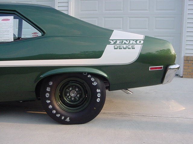

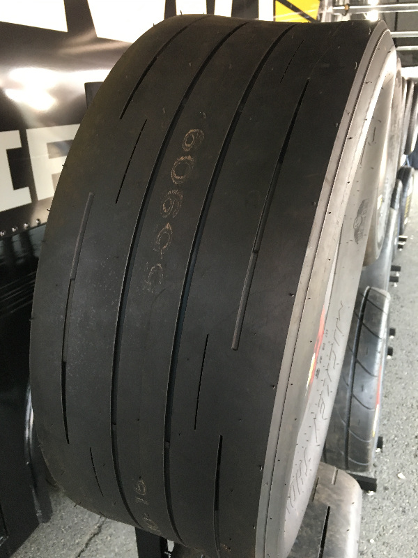

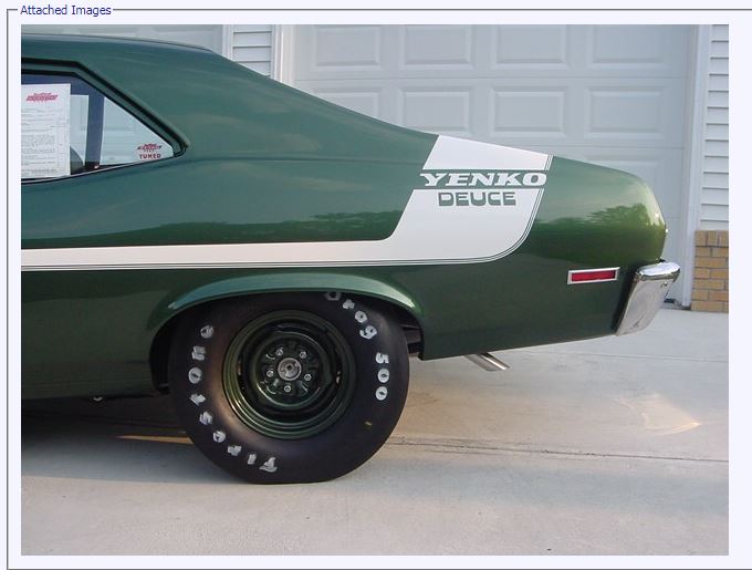

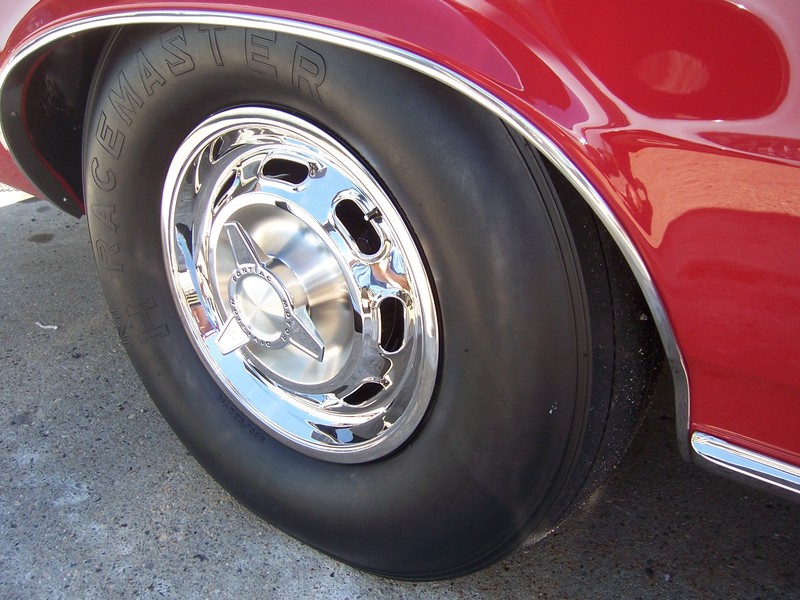

Looking for suggestions for a DOT approved slick with a day2 look that I can buy off the shelf..
70s look.....215-235
This look is just awesome...
