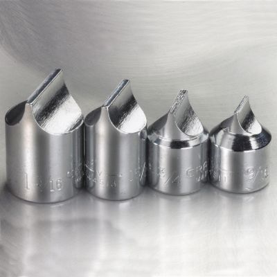

There were several socket to adjust the tie rod ends on early Chevrolets, probably other cars also. I bought some on e-bay for cheap...Joe

Default Re: BBC Water Pump Bypass Fitting
X-2 I use a &quot;Drag Link Adjusting Socket&quot; for heavy duty trucks.
Bill

Big Block Bill,
That looks like exactly what I need.....checking into one on eBay right now!
