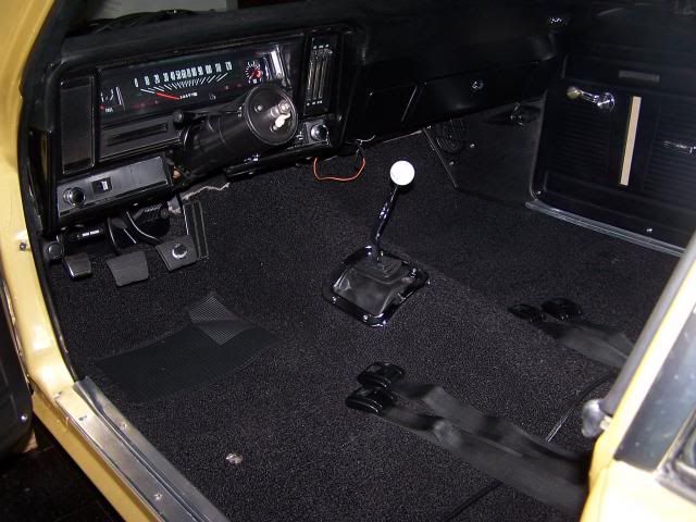

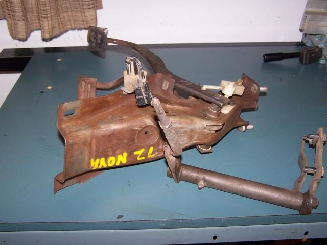

I went from an automatic to a 4 speed, with the 69 Nova. Had to change the pedals of course. They came from a 72 Nova, I was told. The brake and clutch pedals are at the same height. My Chevelle and ElCamino both have the brake pedal lower than the clutch, which makes it easier to drive, because my foot doesn't hit the brake when I push the clutch. Maybe my feet are too big?..
Question: Are the Nova clutch and brake pedals all the same height, or do I have a unique issue here. The adjustment in the brake pedal is all the way in, so I can't lower the brake pedal any more, unless I pull the brake booster out, and thread the rod more.......but then the brake light switch wouldn't reach the pedal arm.
Are all Camaros and Novas like this?

Not sure what the problem is. Dan I can't move the rod to the other hole. The angle would be way off, and really impossible to do. They are not repro's. I'm sure of that. They looked like they were 40 yrs old when I bought them. I can thread the rod farther down the rod coming from the booster, and lower the pedal, but then the brake light switch wouldn't reach the pedal. There's not much room in a Nova to move around. I'll have to pull the seat out and see if I can adjust the rod some more.....or maybe have a foot reduction??

BTW the interior looks really nice. Lets see some pics of the rest of the car please.
