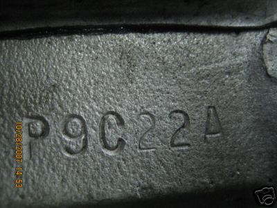

Hope I can get an opinion as to whether or not the following item on ebay, a muncie item# 230215310614 is a restamp or not. Thank you

That transmission is September of 1969, making it a 1970 transmission, not an early 1969 as listed. The stamp on that case is P9P10 P= Muncie, 9=1969, P= September, 10= 10th. Here is a 69 stamp comparison from a Camaro Muncie that I recently sold. I don't know why that transmission listed isn't stamped "C" for M22, as it should being a 1970 trans.

P9P10 Muncie build decodes as...
P---Muncie assembly plant
9---1969 model year
P---Sept.
10--10th day of Sept.
This is an early build trans, Sept. 10th of 1968 for use in a 1969 model year car...
It has no A-B-C ratio designator because that didn't start until the end of Sept. 1968 calendar year, a little more than a month later... Hope this helps... Crash

That's a common decoding mistake with Muncies. As Crash said, the number after the "P" is model year of the car and not the calendar year of the trans assembly.

Thanks for the additional information about this trans stamping. Would any of you venture an opinion as to whether the stamping is original or is it a restamp?

Looks original to me.

Looks original to me too... Crash

so i can understand this, how is the P in this stamping SEPT
9---1969 model year
P---Sept.
Old 01-24-2008, 08:42 AM
RamAirDave RamAirDave is offline
Join Date: Nov 2005
Location: Little Rock, Arkansas
Posts: 450
Default Re: Original stamping?
Its just how they were done:
http://www.camaros.org/drivetrain.sh...missionNumbers
