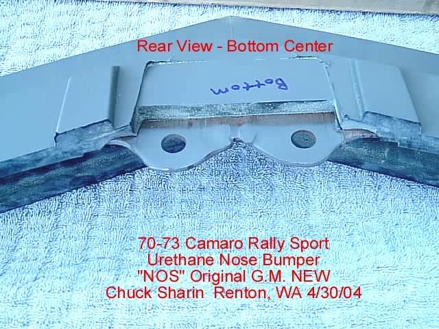

I do know that the factory original G.M. pieces were molded/bonded over a raw unpainted steel frame, with only the four mounting tabs protruding on the rear side. Somehow water finds its way inside and the metal starts to rust. Over time the rusting process causes the blistering,warping, and the delamination/looseness so often seen with these noses. No amount of OUTSIDE massaging or repair will correctly repair the INSIDE cause of the problem.
I read where one fellow cut/sliced completely through one end of the urethane, so as to completely remove it. He them sandblasted, etched and epoxy primered the steel. Using a bonding material such as may be available from www.urethanesupply.com he then reapplied the cleaned original nose piece over the preped steel. This was done having the upper header/lower valance bolted together to use for fitting purposes. A lot of work, but evidently this is a viable alternative if you have a decent core to start with.
There are often used ones on EBAY, in various good, better and best conditions........
I will post some pics of a NOS example..............
