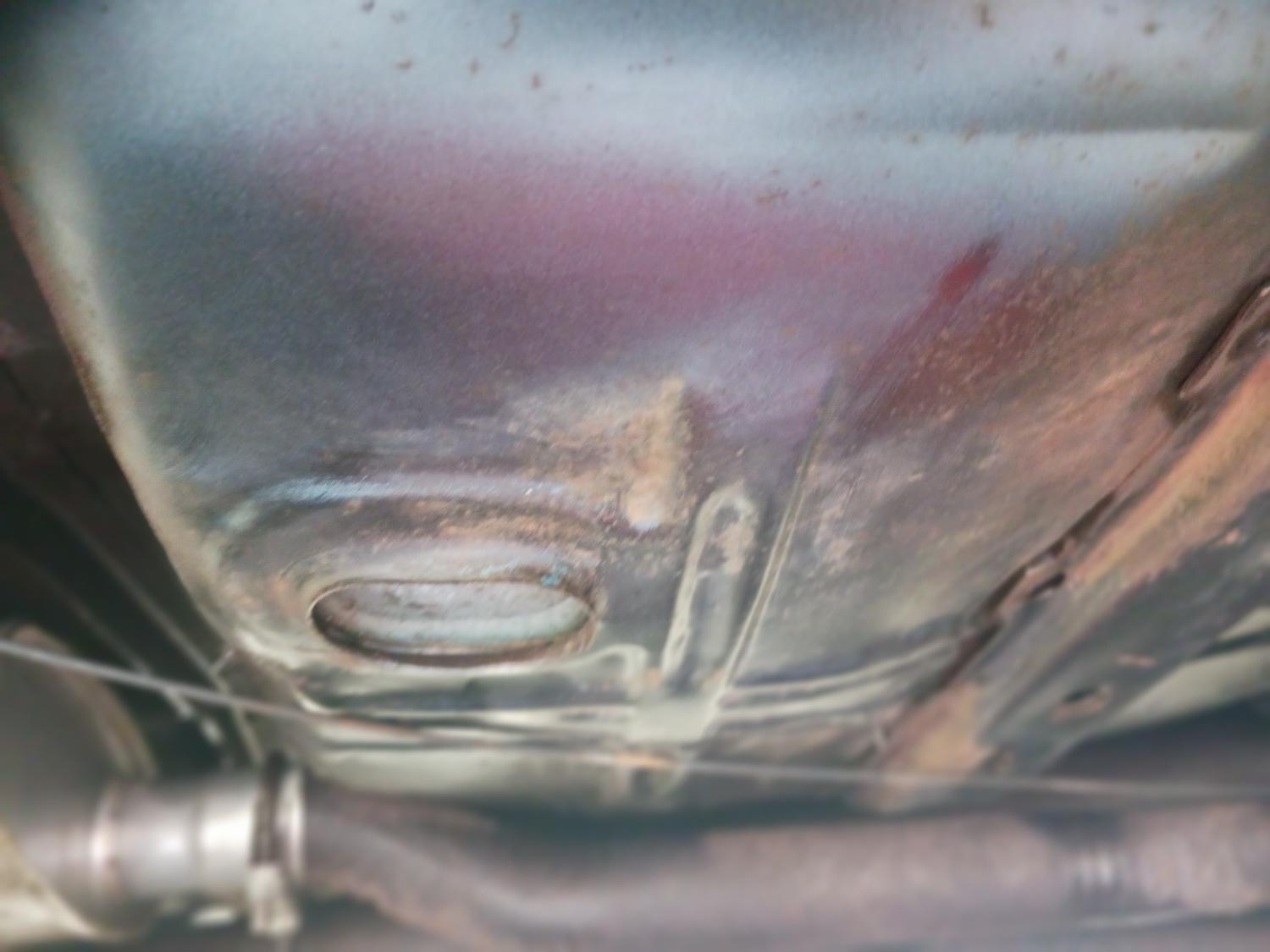

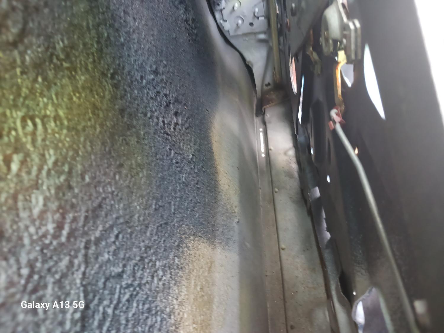

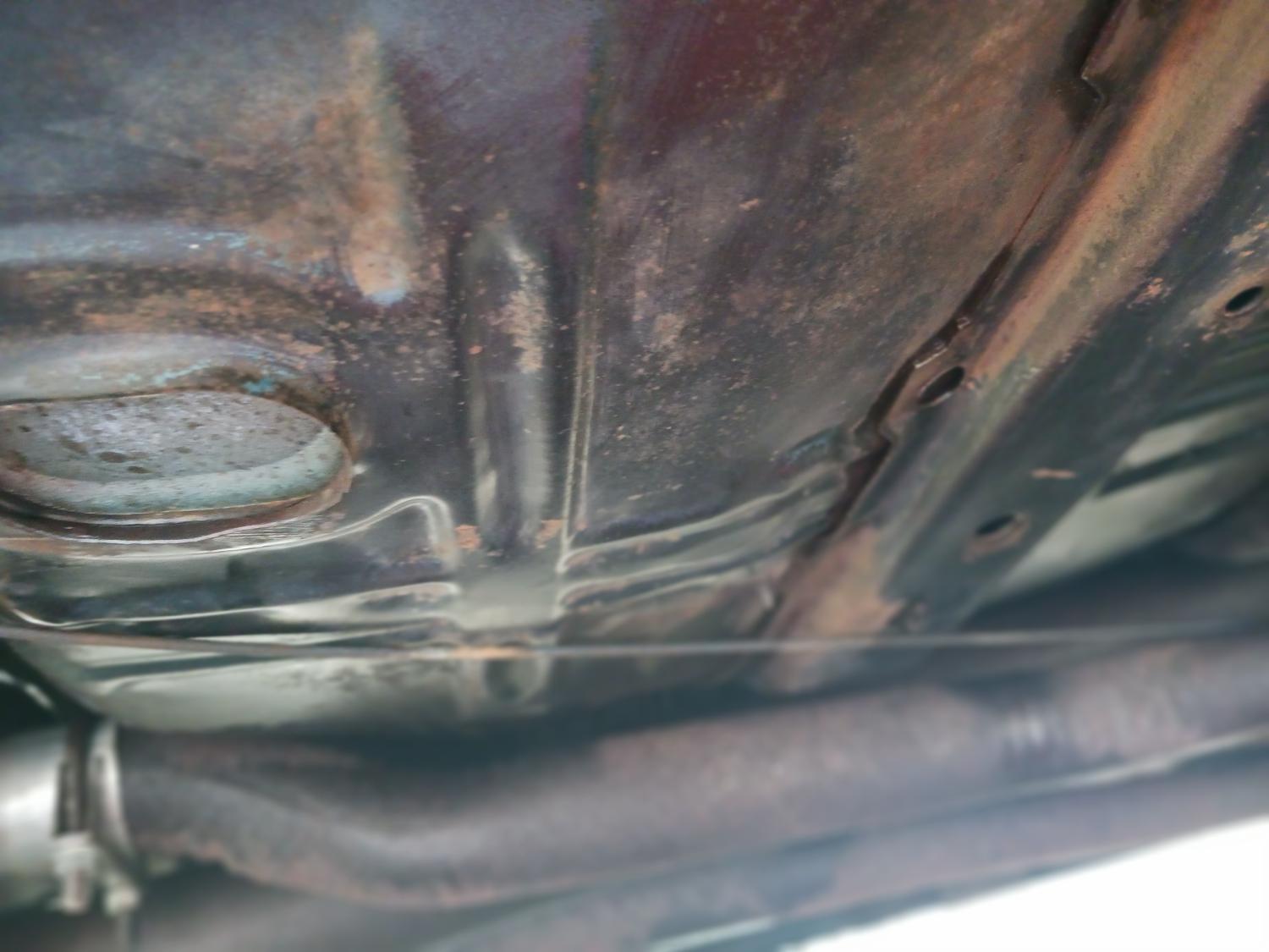

Probably "hillbilly hack" stuff but it worked well.
Gibbs oil and a soft brass toothbrush.
Pic 1 is from sellers ad and is probably why we got it so cheap.
Video on it stated "rusted out doors and floors'
Look that way to you?
Pic 2 is after first round of cleaning and has dirt stuck to oil from driving.
Pics 3- 5 are after first round of cleaning and sprayed with brake kleen.
Pic 6 is inside of drivers door with no cleaning required.
All except pic 2 before oiling.
No current pics bit it is cleaner now.
Most of the brown- crusty looking stuff was staining.
Hosed the entire underside and inside doors- quarters etc. with Gibbs oil.
It does nothing to paint.
GOOD STUFF
