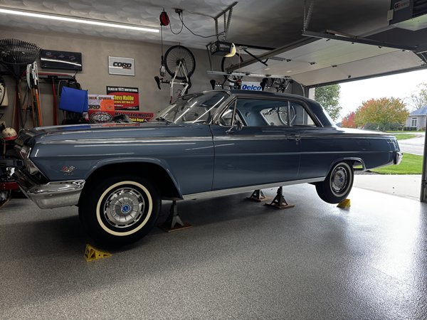

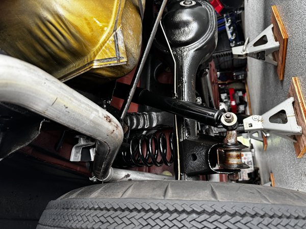

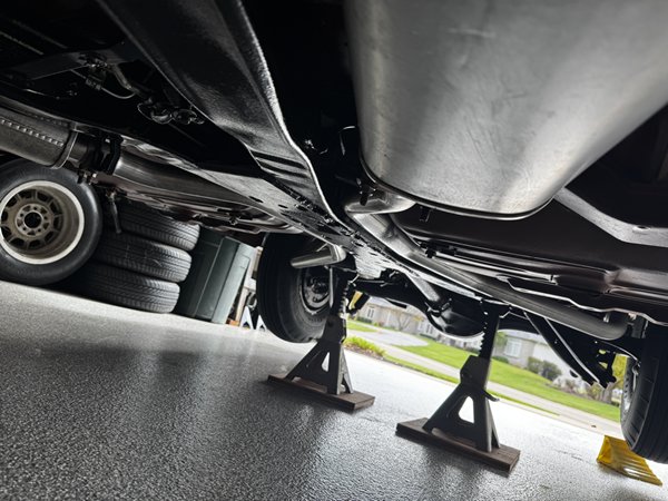

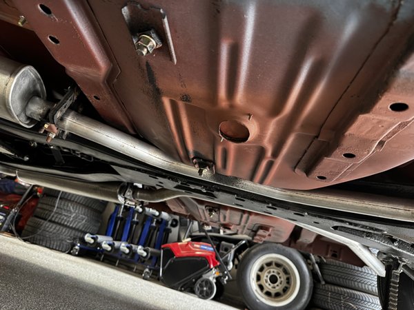

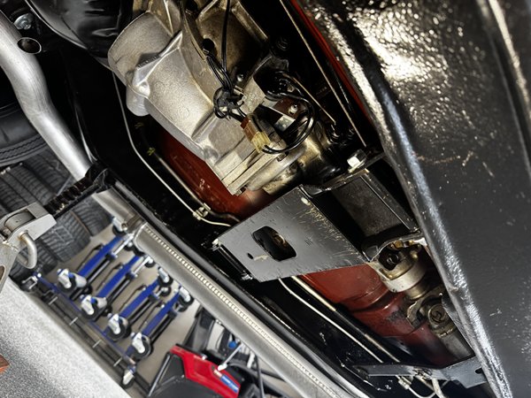

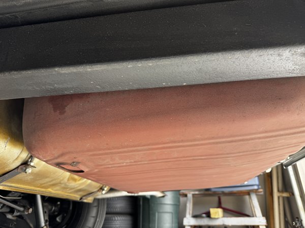

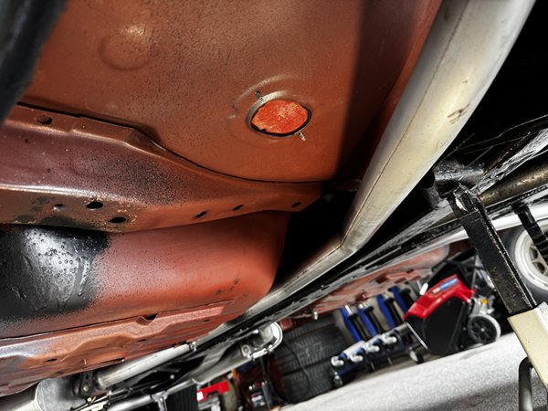

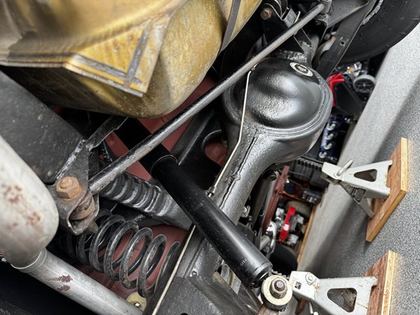

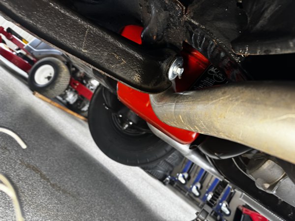

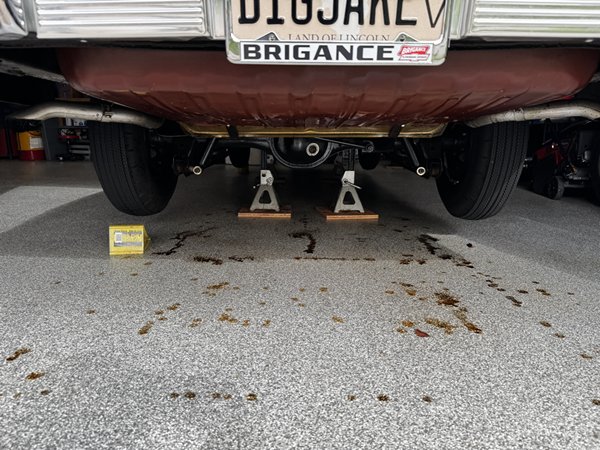

Last big task is now complete prior to MCACN. I've been wanting to clean the chassis to remove a couple decades of road grime and general dust/cobwebs. Getting caught in the rain last month just made things look worse - see before pics below.
I decided to tough this one out and do it on the floor of my garage with the car on jack stands as high as I could get it.
I soaked everything down with Brown Royal - a cleaner/degreaser I've had good luck with as a wheel cleaner. After letting it sit for a few minutes I hit it with the pressure washer, wiped as much down as I could with a towel, then set up a box fan at the front of the car for about an hour.

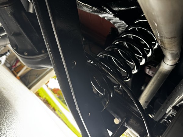

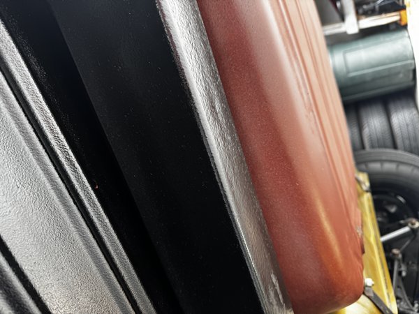

I then took a page out of Tim's playbook and sprayed it down with Boeshield and then wiped the excess off with a shop rag. After that I took it on my 6 mile test route to blow out any remaining water/Boeshield.
I am very pleased with the results.

Turned out great!!!

Jake, you sure you didn't have the body off while we weren't looking??
