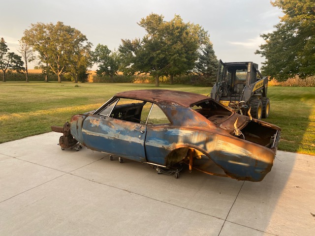

This would be great to take to MCACN. I drug this home recently. I’m going to sell, not keep.
Here are the convincing evidence
1)Clutch boot- all 67 L78 are M21
2) Muncie speedo hole on f. wall
3) brake hold off valve on subframe
4) bb engine frame stands
5) bb fuel line clamp
6) bb heater box
7) traction bar rear stiffening plate
8) black paint evidence on tail p.
9) undisturbed trim tag with 4K
10) all VINs match and are inline and consistent with production timeline
11) all dual exhaust hangars still present
FULL OWNER HISTORY

Great find of a rare car.
Glad I am not in the market. I am getting tired just looking at it and thinking of what it will take to bring it back.

Benny, i would try to buff it out a bit before putting it on the market - buyers love the shine :-)

Yea i seen that! Glad someone here got their hands on it. It deserves to be completely restored.

There were 3 speed l78 and m20.

Wouldn't the 3 speed cable still come thru the firewall in the Saginaw/powerglide location ?
Anything left of the floors, Benny ? Not that I am interested, I'm still in year 7 of my Camaro nut and bolt "light restore".
i belive you are correct. hence, the muncie application.

I can only reference what CRG posts. M21 only as far as Muncies and since it has a Muncie hole I was talking only 4 speeds . Thanks
