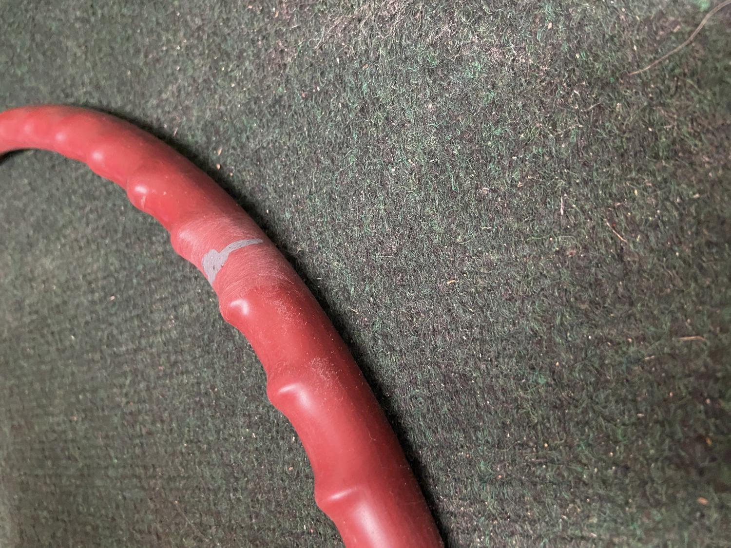

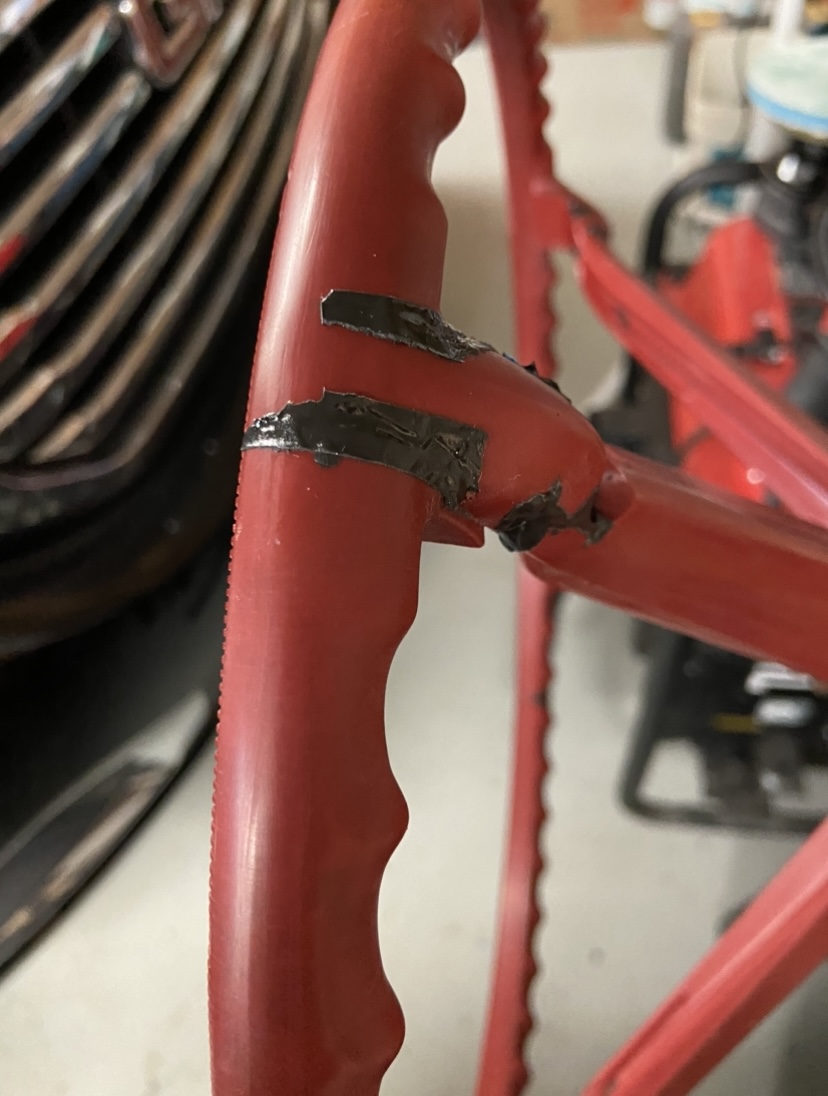

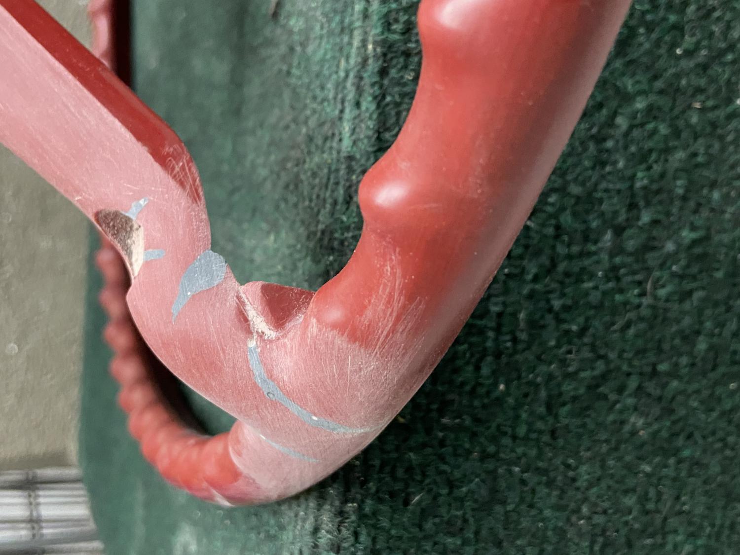

I haven’t done much on the car this past week but did rough out the steering wheel crack filling. The MarineTek epoxy worked great. Flowed into the cracks nicely after I routed them out a little bit, but full bodied enough to stay in place. And shaped easily with a file and then sandpaper.
