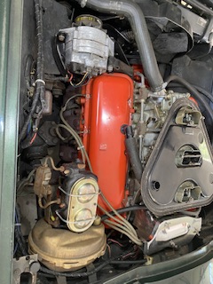

Default 1967 435 original paint on market place 119k
https://www.facebook.com/marketplace...ibextid=T6ff65

Not sure if that ad is legit, but regardless it's an obvious restamp even from the poor-quality FB photos. That is market for a green NOM driver that has some documentation it was actually built a 435.

A '67 435 with no paperwork and without the original engine could have been born anything. A '67 for sale on a big-name forum was advertised this week. It had all the right stuff a 435 should have, but the trim tag showed it was never a 435 with sidepipes. The green car may be pretty, but be careful. I have a good pad picture in my files.

----Can't remember, Tim, but doesn't a sidepipe body have to have been built at St. L factory? I also saw no reference to a build sheet on the tank which would help a lot. Even so,,, non original block at the very least!....Bill S
