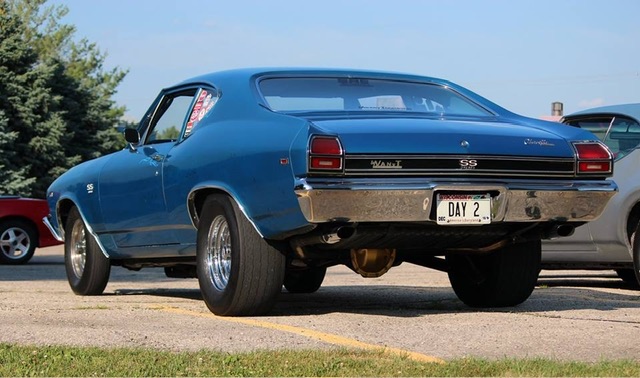

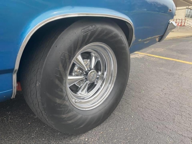

I tried a pair of those on my `67 Chevelle mounted on a pair of Centerline AutoDrag 15X8.5" wheels with 4.875" backspace and they hit both inside and outside wheelhouses.

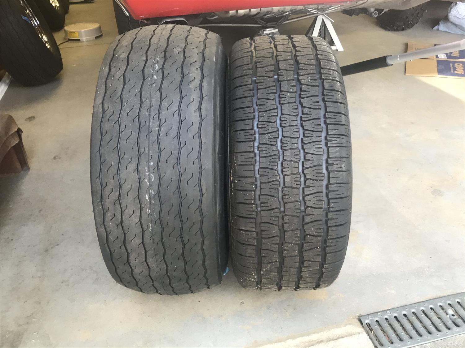

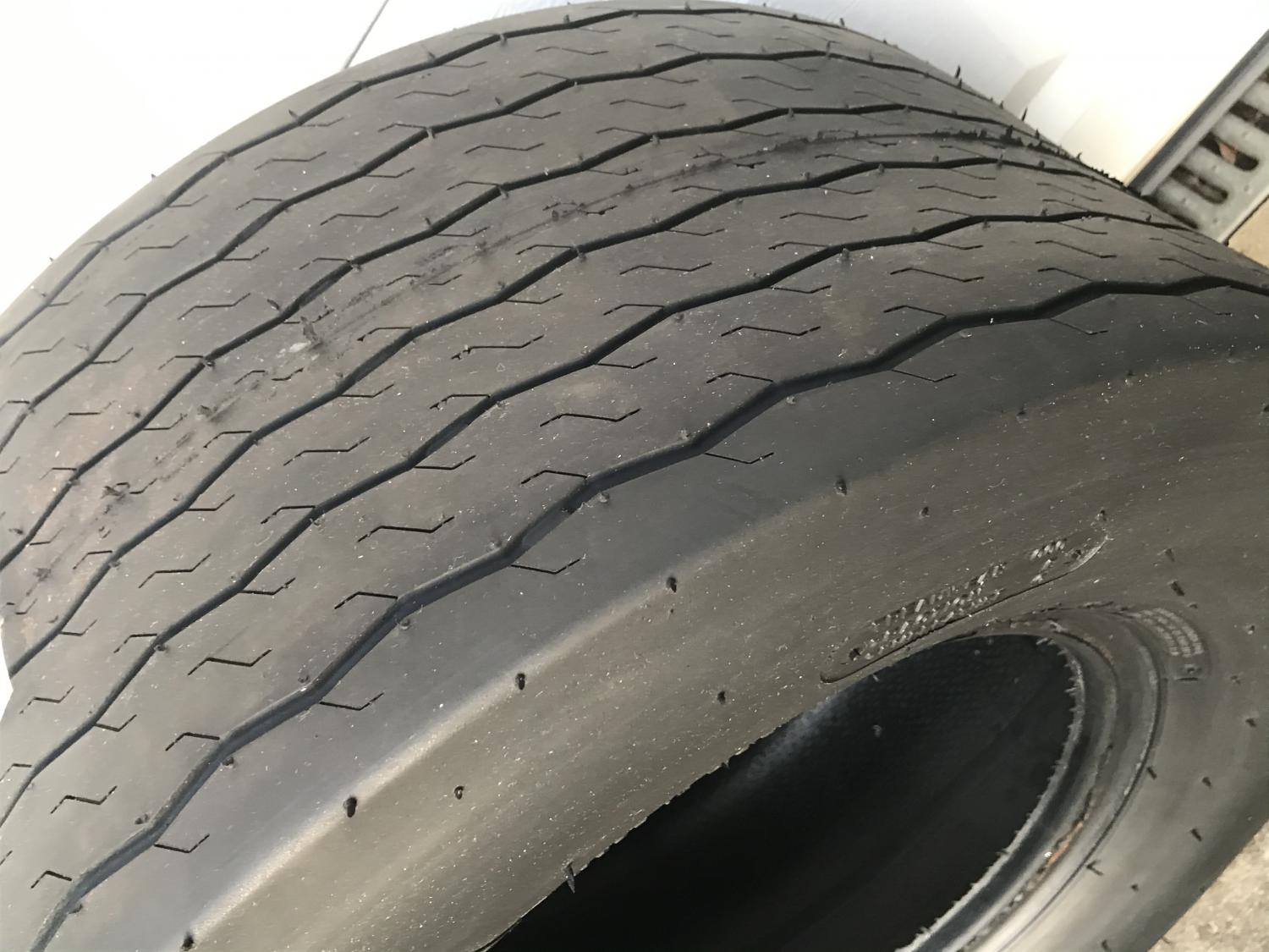

After doing some measuring, I found them to be almost 1" wider in section width than advertised, so they came off and I went with a pair of Hoosiers in the same size. Fit like a glove. A friend has the M&H's now for his `71 GTO street toy.
