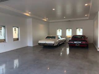

Hi all,
With the amount of accumulated experience visiting this page I figured this is a great place to ask. I am planning to coat my 2 car garage floor sometime this fall and have read many stories of DIY failures for this project but not too many of success. Can anyone recommend a good coating or share any application tips? Unless anyone tells me otherwise, I plan to grind the floor first instead of acid wash. There is regular paint on it now that has been trying to kill us for the last 2 years - slippery when wet... Don't really care about the cost I just want to do it right. Has anyone done this and is happy with the results? Thanks in advance. Tom

Just having it ground and polished is a option.
