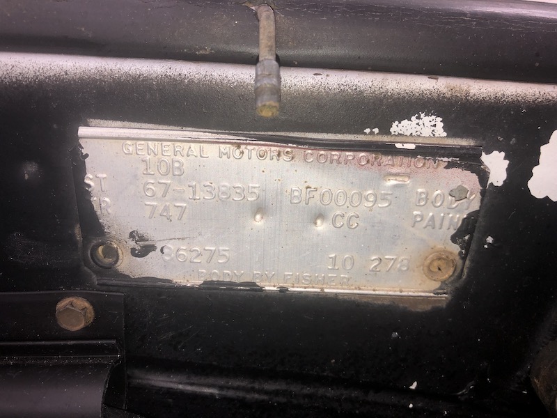

A few numbers:
The trim tag indicates a Fisher body date of 10B at the Fremont CA plant, the 95th Concours body for Fremont production.

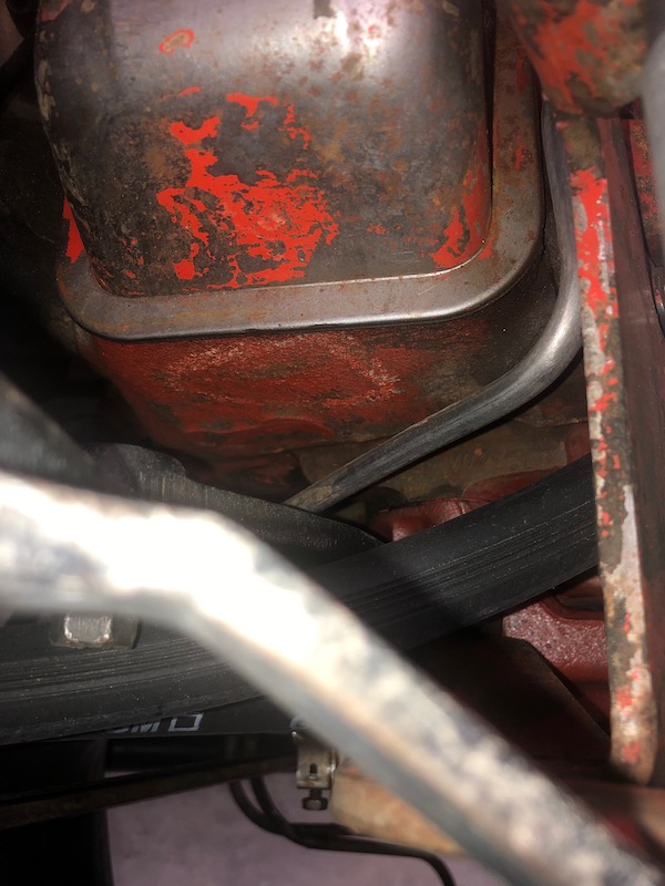

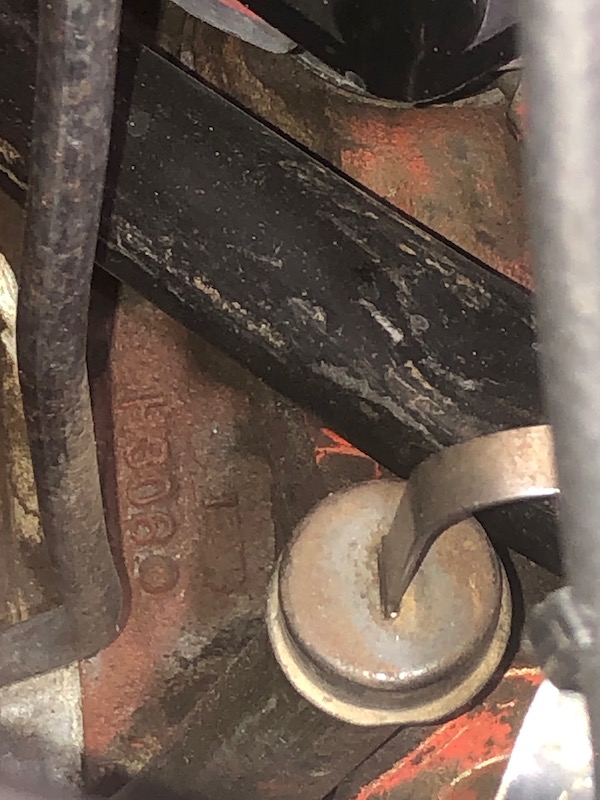

The block casting number is blocked by the Powerglide kick down bracket but with a mirror I was able to verify 3892657, the correct block for all '67 327 until late '67 production.
Block casting date is H306, August 30 '66).

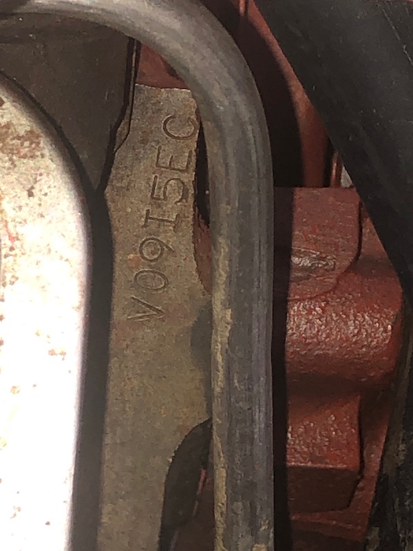

Stamp V0915EC, Flint September 15, EC = L30 327 A/T AIR.
61 Amp alternator 6J12, September 12 '66

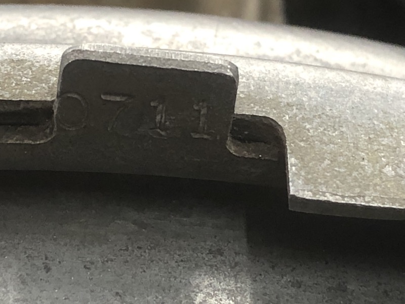

0711 brake booster, power drum brake, Julian date 220
Barely visible is wiper motor yellow ink Julian date 206
Large rad tag is gone but small tag CF
Note chalk mark on RH cyl head

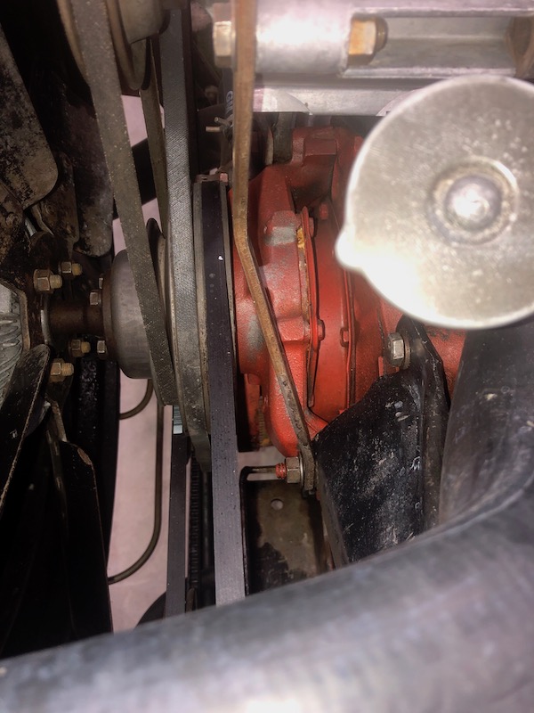

My Intension is to keep painting to bare minimum. Exception, the water pump. It had a parts store pump with a loose bearing. I ordered up a properly dated 608 pump from Bill Mock, it came bare cast, so I rattle-canned a fog of orange, thin enough to not appear fresh.
The timing cover has obviously been removed, so thinking the chain and nylon gear were replaced at some point.

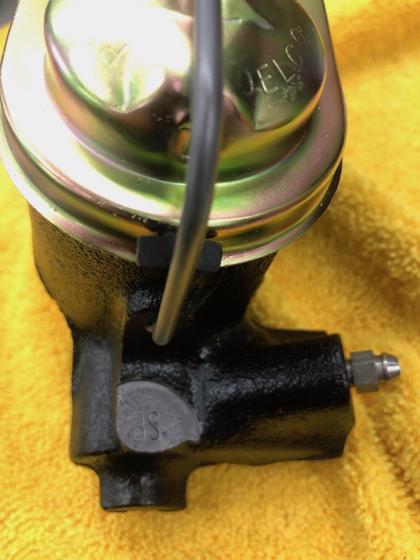

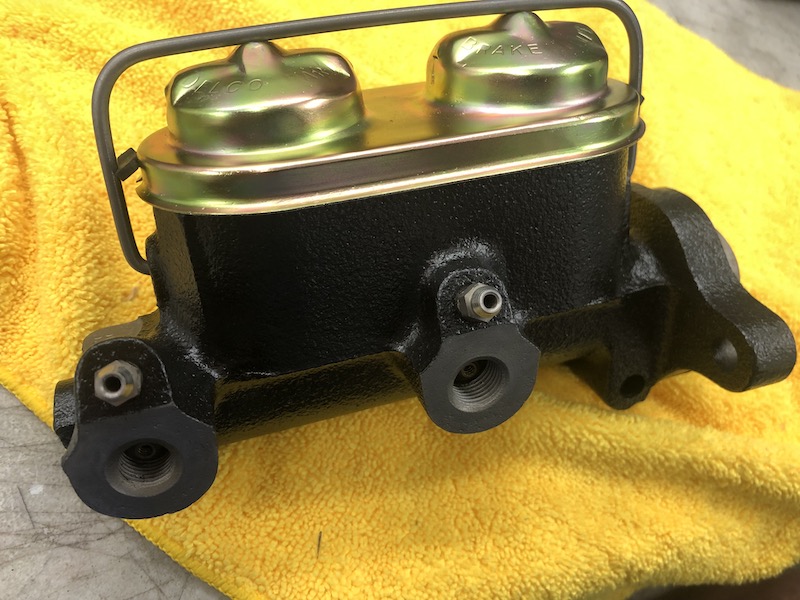

----Bill,,,Is that master cylinder the original? I'm thinking that it doesn't resemble what I'm used to seeing as the car has power drum brakes, not disc brakes.....Bill S
  #50
Old 01-31-2022, 07:23 PM
67since67's Avatar
Join Date: Mar 2016
Location: Waterloo Iowa
Posts: 2,108
Thanks: 3,469
Thanked 5,254 Times in 1,216 Posts
You Sir, are correct! That eyesore parts store POS is still there because I haven't been able to locate a proper power drum Master.
By my October '67 dated parts book '67 drum brake Chevelle and Camaro, with or without power, use the same BS master, or can be stamped CT??
'67 Chevelle power drum masters use a different casting with bleeders, but still stamped BS, like the attached image.
My friendly NAPA guy ordered in four remans, and one is a casting mostly similar to original. My buddy Merl set it up in his mill and duplicated the machined pads followed by installation of dummy bleeders. I need to go upstairs and find a suitable cap and correct early, straight bail.
Still looking for a real, correct master though.
