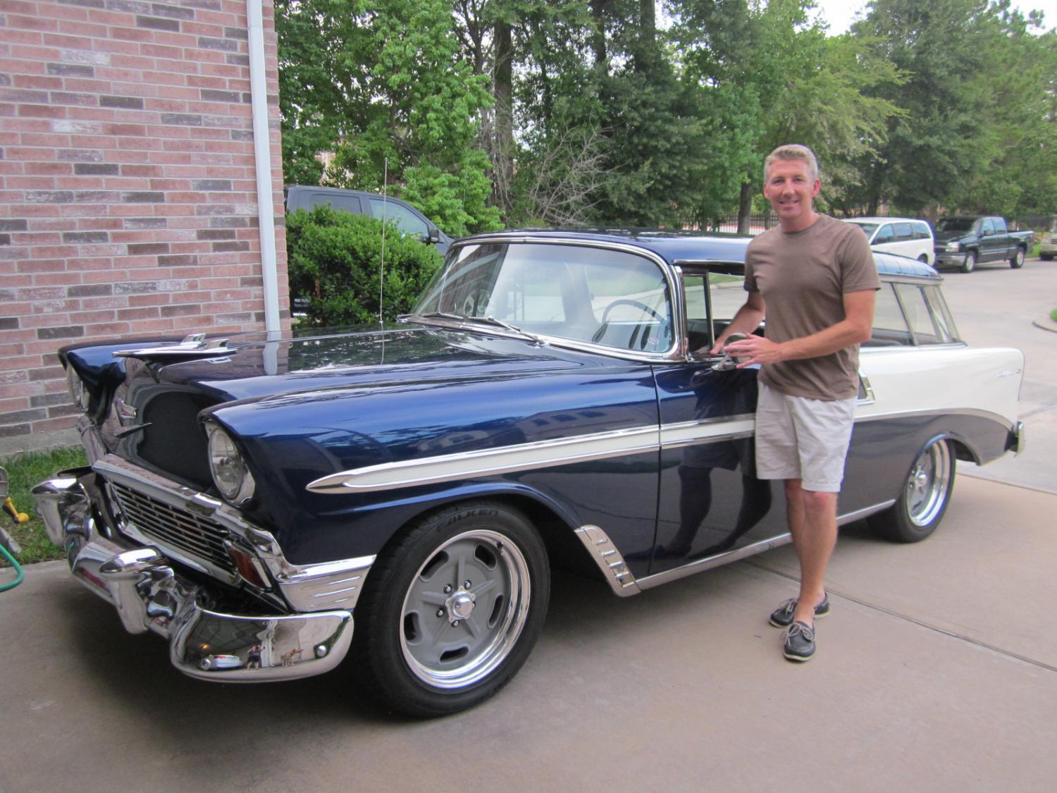

Nice work Mitch! I miss my old Nomad. What a fun and unique car. I restored this one about ten years ago. No gray hair!
Cheers
Dave
