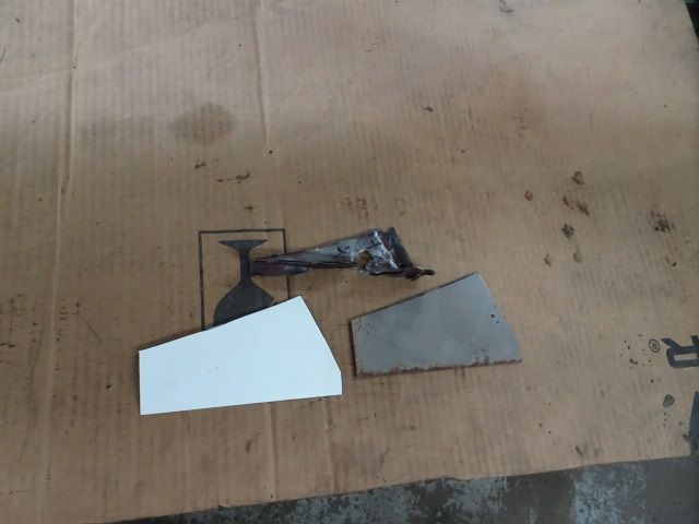

Monday, I was burning off the remnants of an old, brazed on, patch when I realized I had my lower door brace welded to a panel I had to replace...
I cut another tube and moved it back and up on the vent panel.
This is the replacement part.

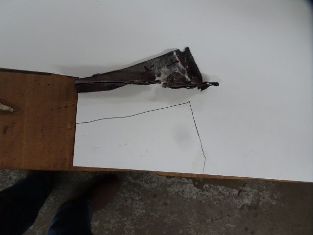

In the process of doing that, I was wire wheeling the area and found rust damage in the toe board and pillar. That was to be Tuesdays work.
I cut the toe pan out and made a tag board template and then rough cut a piece of sheet steel.
I then bent the weld flange and used the stretcher jaws to give the piece some curvature to match the floor.
I didn't take any pics of the pillar patch, but here they are drill screwed in place for floor pan test fit.

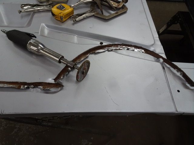

In getting ready to test fit the floor pan, I had to remove the weld flange remnant from the toe board. I don't like spot weld drills for this, as they partially cut into the panel I want to save. Using a grinding wheel is my preferred method of spot weld removal and then clean up the flange with a 80 grit disc.

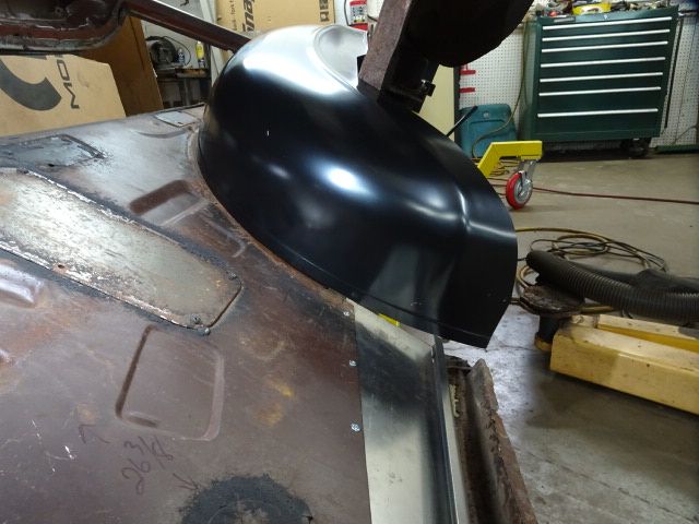

Then I started mocking up the new wide wheel tubs. These are for a sedan, so I cut off the lower part that won't be used on the wagon.
I layed it in place, to get an idea of where I was going to go with this and it seems that it will be easier than I thought to graft this onto the wall. Cutting the cabin and cargo floors will be a challenge.
As well as getting the radius cut in the existing panels to fit the new house into the wall and blending it so it looks like to belongs there.

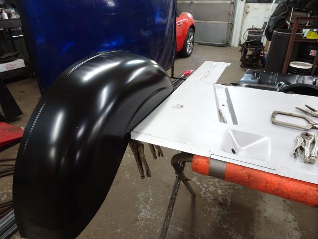

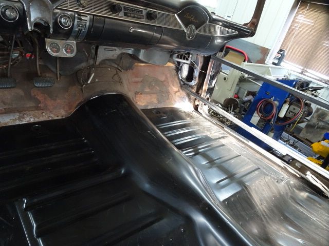

Got the last of the original floor remnants ground off this morning and lifted the floor into place with the lift for a trial fit. I gotta say, this floor fits about as good as anything you could get. I left as much of the original weld seams on the car as a reference and it matches very well.
I've put a number of 1 piece pans in vehicles now and it is still cool. I work 2-3 days getting ready for this and end up with a big hole and, wha-la, 1 piece and it looks like a vehicle again.

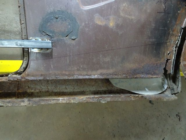

Since that fit so well, I went after removing the left outer rocker cover the owner installed in 1970. I couldn't tell exactly where his seam was, so I just used the stone grinder to remove the edge of the metal, to preserve the original underneath.
I only saw the one spot weld and wondered why. I found out quickly when I started grinding off the paint. The whole seam is leaded... That's tomorrow's removal process.
