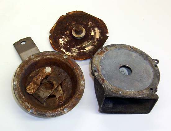

I used the Evaporust to get my 1970's Z28's frozen horns to working again. Set the horns up in a vice, filled to capacity and let sit for 2 days. I also soaked the horn relay for 1 day.
Rinsed everything out with water and dried with heat gun. Horns are working!
