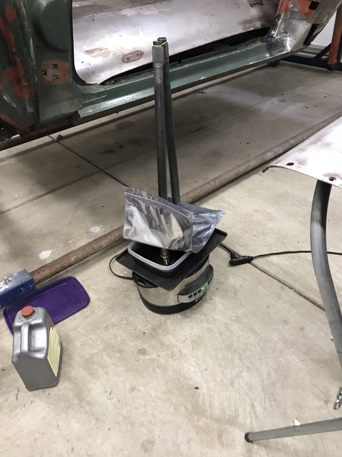

Old 10-18-2020, 10:13 PM
Join Date: Sep 2016
Location: Dayton Ohio
Posts: 950
Thanks: 331
Thanked 477 Times in 261 Posts
Default Axle flanges
Axles in Evaporust tub
Owned since 1978 - First Car
