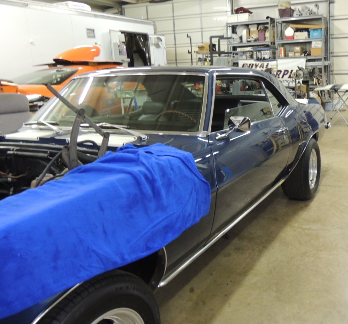

Default Engine Out
Got the Bill Mitchell Hardcore engine out.
Took a few pics. Car does not have the original master cyl and booster on it now, but I found them in the parts stash. Also found the original fan clutch. It is in almost mint condition. Still has the correct date coded 772 fan as well.
Attached a pic of the trim tag and couple pics of the car. Like i said, was fathom green originally. Is this Dusk Blue?
