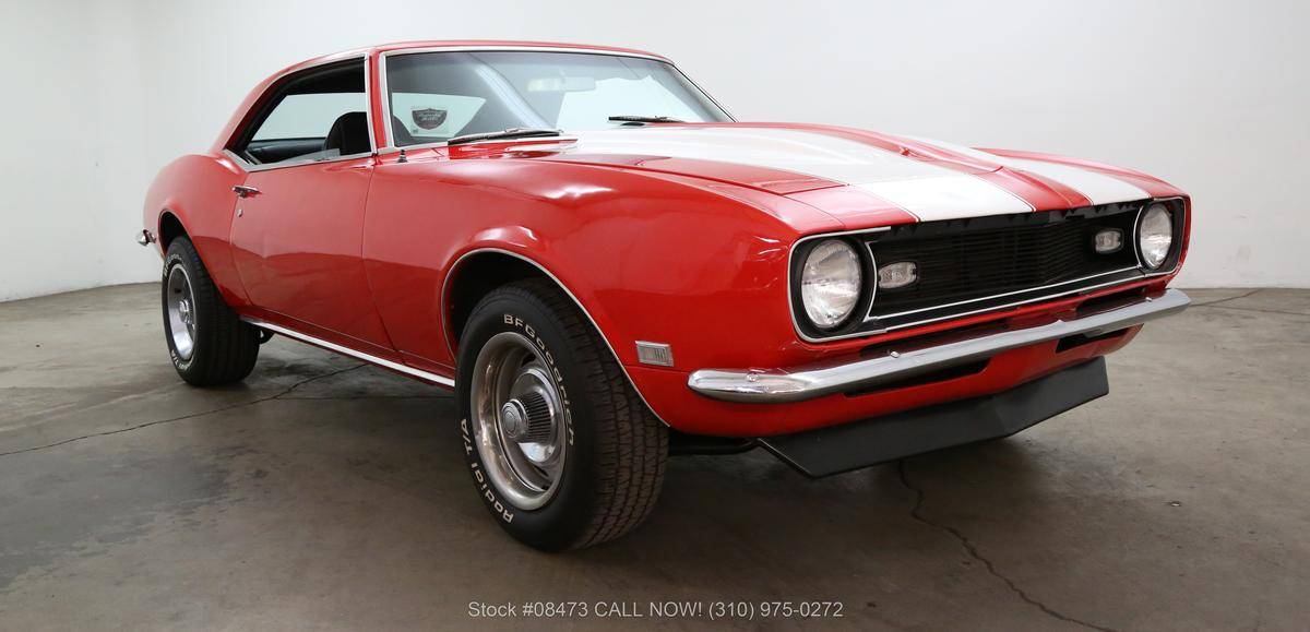

https://s26.postimg.cc/56i0v6lux/image.jpg
Seller’s Description:
1968 Chevrolet Camaro
'68 Chevrolet Camaro in red with white racing stripes and black interior. Comes equipped with a 327hp engine with an aultomatic transmission, power steering, updated dash and gauges. Very clean and presentable. Mechanically sound.
For $19,950 USD
https://www.hemmings.com/classifieds...o/1965906.html

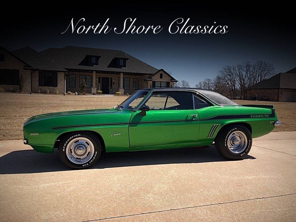

https://s26.postimg.cc/kt9a814mh/image.jpg
Seller’s Description: Check out this Beautiful 1969 Camaro Refinished Rallye Green Base Clear over a solid Straight Body . All glass is Excellent all Trim is Excellent . 4 Brand New white lettered tires on 15 inch Rally Rims. Interior is excellent Door Panels are in wonderful shape Dash is Excellent Headliner and Carpet are Excellent. Engine is a 350 With Nice Cam, 400 Hp+/Power Disc Brakes. Power steering. Trans is a 350T with Shift Kit .This 69 Camaro is Ready to Cruise Or Show A very Beautiful Dependable Machine at a Very Fair Price. PRICED TO SELL CALL US 847-393-7887 x107WE FINANCE/DELIVER
Price: $27,500
https://www.hemmings.com/classifieds...o/2092314.html
