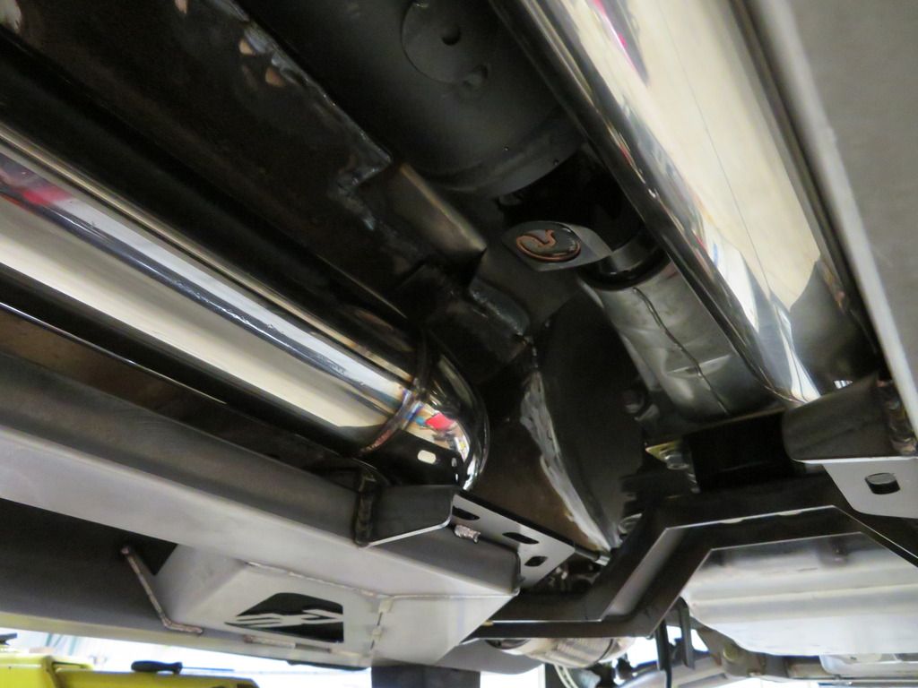

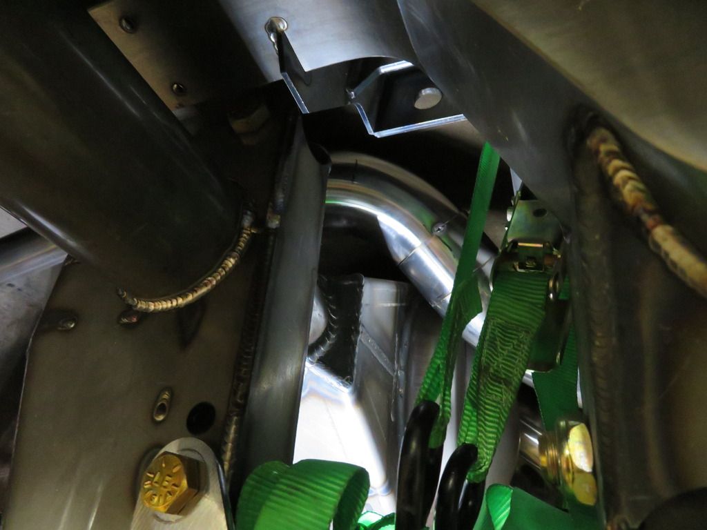

And now building the exhaust. I wanted the tail pipes to go over the axle. It's going to be tight, but it will fit and work.....
I will be able to fit the tail pipes between the frame rails and the fuel tank to hide them the way I wanted to.
