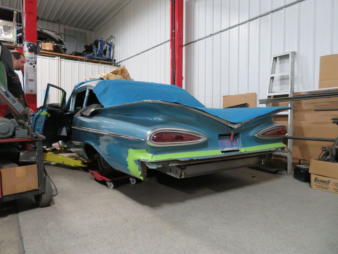

napa68 01-28-2018 06:16 PM
Some people ask..........what ya up to these days?
I had a perfectly good driver hot rod..................right? What does one do? Take it apart!
Here is my latest endeavor, revisiting my 59 Bel Air.
I will keep the original paint, and the overall look of the car won't change much. I'll even see how much of the original interior I elect to maintain. That's where it stops. My goal is to improve the car in these areas.
-Handling. A nice stiff chassis to take the squeaks and rattles out of the car and maintain a great ride quality. Not that I plan to autocross this, there is definitely room for improvement. I am thinking a 12" wide rear tire which may require mini tubs. 10" wide rubber in the front.
-Braking. It stops well now, it can be better. An engineered chassis and brake system will improve overall braking and thus predictability. I'll be limited in brakes as I am going to maintain a 15" wheel so I have no issue with the hardcore 1964 and earlier events. (I'll just keep the hood closed)
-Comfort. Vintage Air HVAC as well as revisiting the seats. I am wanting to keep the bench seats and the overall feel of the interior. Modern foam in the seat so as I feel a bit more "planted" while in it. I suppose there may be some mods to the seat frame so I can get some lumbar support and perhaps a bit better ergonomics. We will see there. LOTS of sound deadener!
-Power. LS3 / 480hp with 4L70E Connect and Cruise
-Theme. The theme wont necessarily change much. I want a car that looks like it got parked in the mid 60's, and then recommissioned recently. My original vision was a car that could have been parked around Gasoline Alley in mid May of 63-65.
On the docket........................
1. Roadster Shop chassis
2. GM Connect & Cruise power
3. Refinish the underside and engine compartment to the standards of a modern build. I am drawn to an OE feel and sensibility.
Before disassembly...........
http://i1043.photobucket.com/albums/...psq2o16s32.jpg
http://i1043.photobucket.com/albums/...psifttp9a7.jpg
http://i1043.photobucket.com/albums/...psffmmyp3s.jpg
http://i1043.photobucket.com/albums/...psz0wur5na.jpg
http://i1043.photobucket.com/albums/...pspc3daiww.jpg

And now the fab work begins..............
The new hat channels for the additional body mounts and the floorpan mods to fit the new chassis.
http://i1043.photobucket.com/albums/...pshkbgw1kl.jpg
http://i1043.photobucket.com/albums/...psypes04do.jpg
http://i1043.photobucket.com/albums/...psumzvqtxf.jpg
http://i1043.photobucket.com/albums/...psqjx083ic.jpg
http://i1043.photobucket.com/albums/...pspzfnluty.jpg
http://i1043.photobucket.com/albums/...psdga1gxxc.jpg
The chassis fits like a glove! Plenty of room for rubber and what looks to be a killer ride height.
http://i1043.photobucket.com/albums/...ps5ejxmriq.jpg
http://i1043.photobucket.com/albums/...psbvpouhc7.jpg
http://i1043.photobucket.com/albums/...pspjho0wvk.jpg
http://i1043.photobucket.com/albums/...psaph2spj0.jpg
http://i1043.photobucket.com/albums/...pszizu50re.jpg
So.................that's where all of my lunch money is going!
