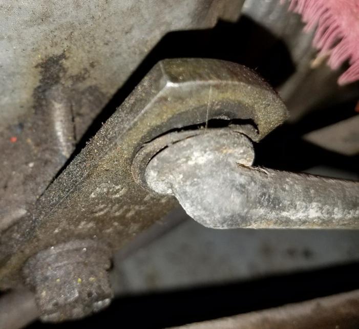

On 1969 s/b hurst linkage what is correct to hold linkage rod to shifter & side cover arm to the rod
Attachments - The Supercar Registry wave washer.jpg reverse rod hair pin.jpg lever rod with wave washer cotter pin.jpg DSCN5864.jpg

That would be the clip on the left.

Ok thanks just wondering way the factory asembly manuel shows cotter pins ?

I was gonna reply but was not sure, did some have cotter pins on the shifter.

I know for a fact that aftermarket CompPlus Hurst shifters (example) came with the clips shown on the left -- they did not use cotter pins. The clips can be a pain in the south-end to install and sometimes go a-flyin' -- that's why there are Hurst shifters out there with cotter pins ... and they rattle like an SOB ... TAZ

Original were cotter pin and wave washer. I'm not referring to after market Hurst.

Must be before the late 60s ... every aftermarket Hurst I have seen/installed had the clips ... TAZ

Thats correct i am working with a factory installed hurst 4 speed shifter not a after market unit

The factory shifters and trans levers also incorporated rubber grommets at the rod connections to minimize noise. Aftermarket shifters used bushings and clips.
