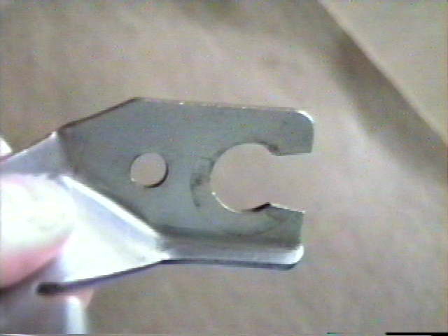

Rick, Do you have comparitive pictures of the similar but different cable brkts , to include Chris's repop............

Everyone calls it something different. The bracket on the right was plated for Chris White by someone he uses. The one on the left was done by Steve Gregory and he calls it zinc phosphate. Seems most people generically call it gray phosphate.
Not saved in my picture files but if you do a search on here, they were posted more than once.

Try these
PJ

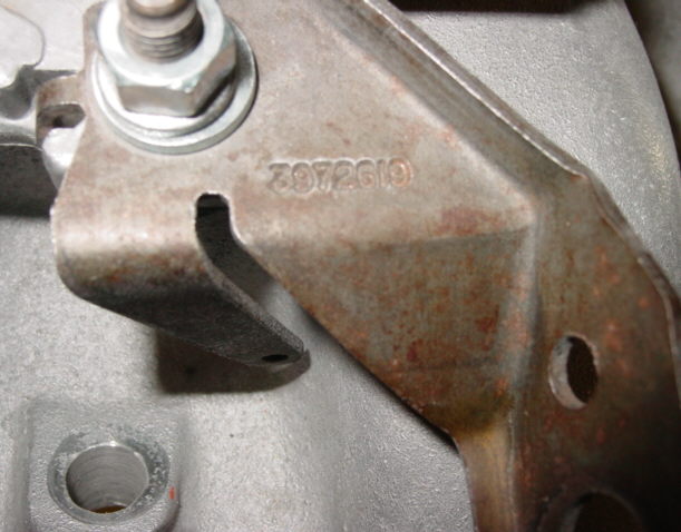

Posts: 1,320
Default Re: Question about throttle cable bracket finish????
I have also seen one that looked like rust colour just like the previous one. The pic is courtesy of Chris.
