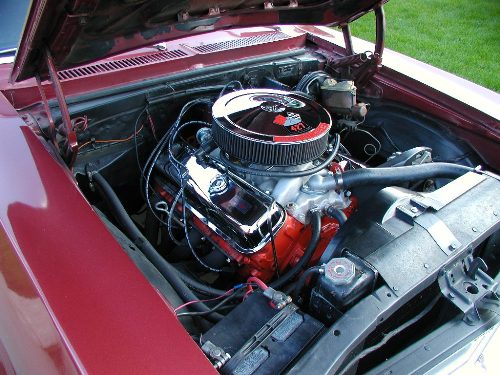

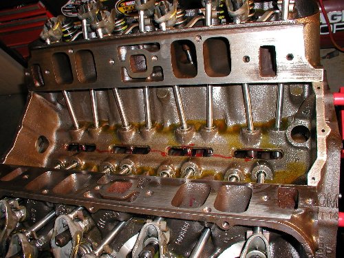

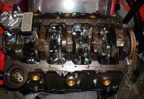

Newbie here. I have a 69 Camaro SB SS clone and have been thinking about putting a 427 in it. Can someone please tell me where I can find build specs and part numbers for a 427? Which engine books to buy, web sites to go to? I need to educate myself on the 427 before I make the leap. The pic below is my 69. Thanks guys

Beware of 427 tall blocks, found on some larger trucks. Passenger intakes will not fit without spacers on the intake.
The 512 block was available in both 2 bolt and 4 bolt versions. If you find a full motor, great, but if you are doing a 427/425 COPO look-a-like, then you'll be changing heads, intake, carb anyway, so a block only would be a good starting point.

build your own home grown version. 454 block 396 crank 427 piston mine made 622 hp on dyno.
