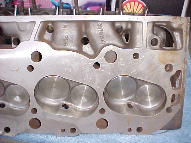

Here is the photo of the 840 head that I thought was
dated H 24 70 ...or am I misreading it?
...or is it H 24 7
Old 10-17-2007, 03:31 AM
John's Avatar
John John is offline
Join Date: Nov 2001
Posts: 3,395
Thanks: 2,739
Thanked 454 Times in 191 Posts
Default Re: bbc head APPLICATION
Here is the other side of the same head

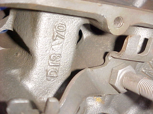

here is the 291 head dated D 13 70
