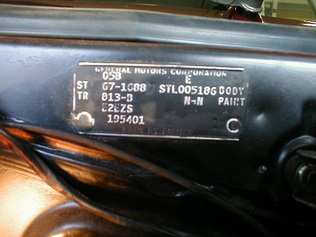

Does anyone Know where to get the trim tag decode info for a 67 Impala SS??
I can't seem to find it on the web??
Here can someone Decode This...
General Motors Corperation
05D E
ST 67-1688 STL005186 BODY
TR 813-B N-N PNT
E2EZS
195401
Thanks Randall
Attachments - The Supercar Registry 254105-67ImpalaSS002.jpg 254100-67ImpalaSStrimtag005.jpg

Hey Randall,
Your tag decodes as follows:
05D: body made 4th week of May
67-16887: 67 Impala SS Spt Cpe.
STL 005186: 5186th 67 SS Spt Cpe body built at St Louis, MO
813-B: Black Bucket interior
N-N: Madiera Maroon exterior
E: tinted glass
2E: Factory A/C
2Z: Turbo 400 Trans
2S: Manual rear antenna
195401: work order code
There might also be a handstamped number somewhere on your tag. Would it be possible to get a picture of that tag? My brother and I have a cowl tag database. We are currently up to almost 5000 cars. Could you also send me the vin number of your car? I need it in order to put your car into our database. I think the vin will be around 208000 to 209000.
Thanks!
Steve

Yes on the lower right hand corner of the Trim Tag is a #17
What does that mean??
Send me your E-mail so I can send the pictures of the tirm tag, Also do you want a copy of the Original Invoice??

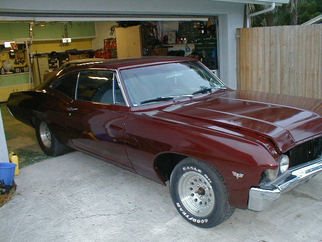

Sorry I forgot to give you the Vin# 168877S190504
I have the Original 327/275hp motor and 400 trans in the car

Picture of the Impala SS
