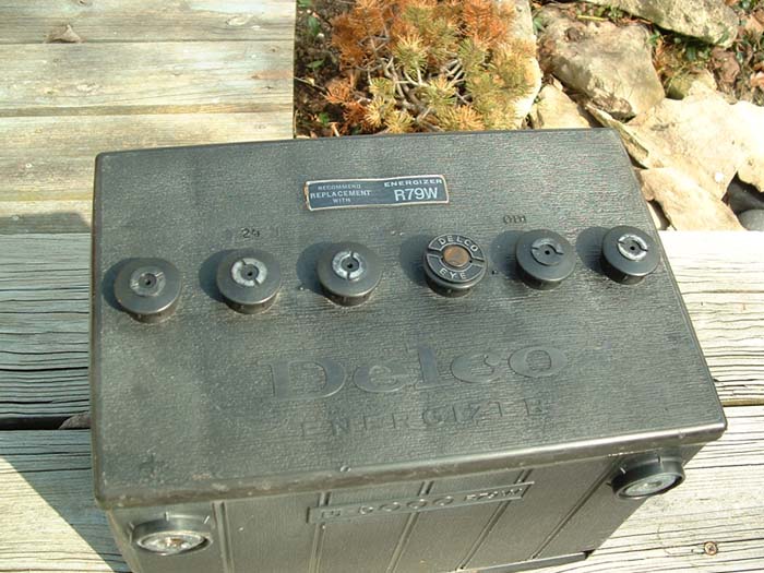

Here's my "no good, used, 36 year old battery that came with a car new".

I have to agree with Dennis, the is wrinkly is correct. IT'S JUST LIKE DENNIS WRINKLY!!!

Hey, come to think of it, do you have pix of the battery that was in the 'Benchmark car'? That was as close as I've seen to correct. I think Dean told me he even retapped the Neg terminal so the correct bolt worked, and I know it was date stamped.
