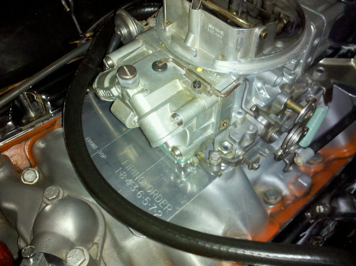

I've seen a few cars at local shows that have the carburetor head shield with the engine firing order stamped into them. Are they factory pieces and what and when is there application?

Yes they are and part of the RPO NA-9 package.
Also known as EEC for Evaporative Emission Control or Charcoal Cannister system ,or California Emissions.All the same animal.
It originally was mandatory on vehicles sold brand new in the state of California & certain parts of Nevada & Montana.
It soon became standard equipment in all states,on most vehicles as the years moved on.

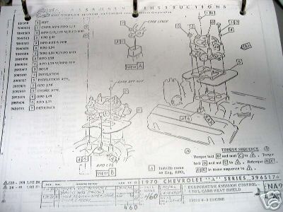

Does an L34 70 Chevelle with the NA9 RPO code on the build sheet use a carburetor heat shield with the quadrajet carb.?
Howard
Growing old is a certainty, growing up isn't
Old 08-17-2006, 08:11 AM
Posts: 21,049
Thanked 3,840 Times in 1,522 Posts
Default Re: Carburetor Heat Shield
Absolutely..it was not just for Holley equipped engines.
All 1970 Quadrajets used part #3969837.

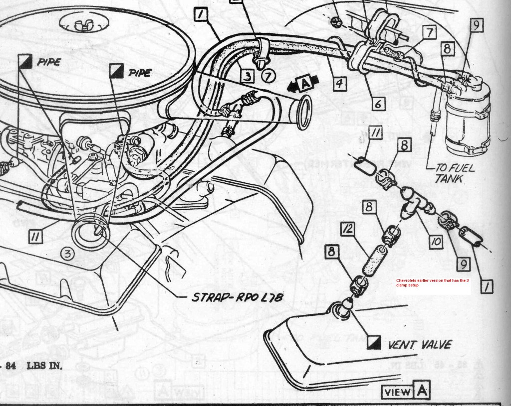

Was the heat sheild and the charcoal canister system the only components of the NA9 RPO code or was there other components added.
Old 08-17-2006, 08:28 AM
Posts: 21,049
In addition to those two items,there was a seperator box mounted over the rear axle,special vented gas tank and gas cap,and a Special Carb with a fuel bowl vent pipe.
This system took the fuel vapors from the carb.and routed them to the charcoal cannister where they were then returned to the gas tank via the seperator.
