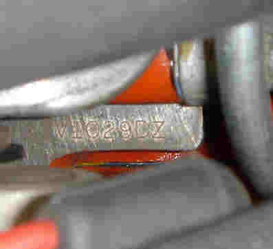

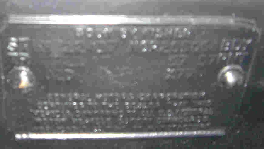

Hello,
I am looking a buying a 1969 Z28. I am into Pontiac's but I have always liked the 69 Z28's. My question is:
Where is the vin sequence number stamped on the engine block and trans? I have all the books for the Camaro's and none of them tell you where these numbers are located.
Yes, it does have the DZ stamped on the passenger side on the deck. It has a few other numbers there also. With no POP or Buildsheet, I just want to verify if the block "matches" the car. It in a X77 car via the data plate.
Please help, I would like to jump on this car soon.
Thanks!!!
Steve

Picture of DZ stamp on engine block.
Steve

Picture of Cowl Tag.
Steve

Sorry for the bad reduced picture of cowl tag.
12437 NOR 265068
TR 721 57 57 PNT (Green with Green interior)
02D X77
Steve

Ok, I am answering my own questions here. I would like to be correct in my thinking.
The date on the cowl tag is 4th week of Feb.
The VI029DZ on the engine block is:
V = Flint
I = ????
02 = Feb.
9 = 9th day of month.
DZ = 302 Z28 engine.
What does the "I" stand for?
So with this information, the block was produced two weeks prior to build date of car. Am I correct???
Steve
You have it a wrong. Correct is.
V= Flint
I0= October
29= 9th day of October
DZ= 4 speed only High Perf. A.I.R.
An "I" was used in place of a "1" in a lot of cases.
Engine seems to be a tad early for this car. Check the partial VIN on motor against the VIN of the car.
Rick H.

Wouldn't the "29" be for 29th of October then?
Thanks for the help.
Steve
Old 02-11-2006, 08:30 PM
Posts: 21,048
Thanked 3,815 Times in 1,520 Posts
Default Re: Decoding a 1969 Z28 - Help Please...
Yes..I'm sure that's what he meant.Just a typo.

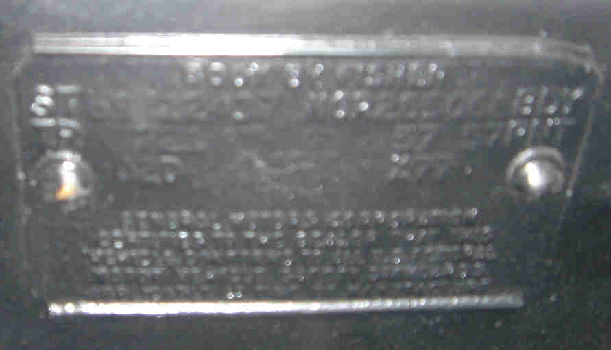

Need a better pic of the trim tag. What is the VIN?

Here is a better picture of the cowl tag. Hopefully it is a better picture.
I have not looked for the vin near the oil filter yet. I am going to look at it on a hoist now. It was on the ground when I looked at it. I took a few pictures but I forgot to take one of the VIN.
Steve
