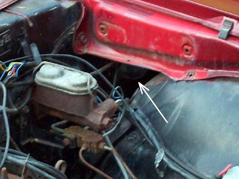

Hi Guys, is there any easy way to replace the AC vac. tank inside drivers firewall, without taking fender off.
Thanks Joe

Joe, the only way to remove/install this tank without removing the fender is to drill a 5" diameter hole in the inner fender. This is the same procedure that is in the service manual for replacing a blower motor on the opposite side. I am assuming that your car is a car that does not need restoration, if so, then you will have to remove the hood and left fender to replace this item if you do not want to scratch the paint on either the inner fender or fender. I wish there was an easier way to get to it. See the picture attached of my 67 RS with a/c. You can barely see the tank in the picture................RatPack............
