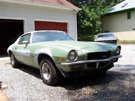

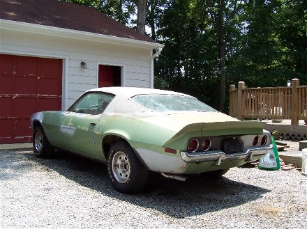

Default Re: 1970 L-78 Camaro CKO block
Here are the pics I have so far. I don't have a pic of the cowl tag yet but here is the info.
Another pic

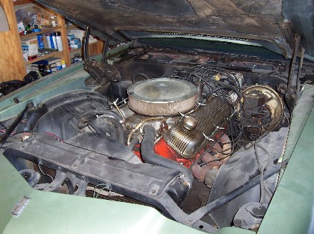

and the engine. The original exhaust manifolds come with the car.
Does he have the Dual Snorkle Air Cleaner for it?
Make sure the Ex.Manifolds have A.I.R. provisions.
