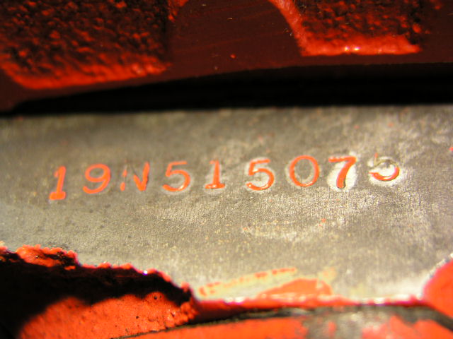

I'm going to look at a 69 Z-28 tomorrow. Supposed to be #'s matching semi-untouched car. Last owner many years. Not a savvy guy.[Me or him!]
Numbers on the pad match the VIN. [Anybody got a pic of a what a DZ pad should look like?}
No 'X' on the trim tag.He says not all Z-28 were 'X code'First 4000 were plain[?] something cars and I don't have a clue...been searching the web figuring there would be a site with a list of all the right parts and numbers to look for but as of now...I can't find it.

If the car was to early to have an "X" code (Norwood cars only) then the big thing would be checking that the numbers match on the engine pad/tranny. Is there any paperwork or Protect-O-Plate (POP) with the car? Also check the rear end codes on the passengers axle tube facing foward.

If the car is an early Norwood car it may still have an "X" Code on the vertical reinforcement behind the rear seat back, on the passenger side.
You should find a local expert to assist you. A few bucks invested can go a long way.

The 1969 Z/28 is the most cloned car ever.
Be very carefull. Post the tag and the stamp pad for verification.
Look for single fuel line - holley cars had them.
Bracket for dual exhaust - only SS or Z cars had them.
Make sure the trim tag is not a "replica" - most important.
Check for original DZ stamping - easy to tell if you know what to look for.
Later cars have the vin by the oil filter.
Too much to learn in 5 minutes - post the pictures.
Also - no 69 Z's had A/C or Auto trans.
They all came with smog (Correct E-manifolds cost $1500)

Here is my early Norwood Z with the vin on the pad.
