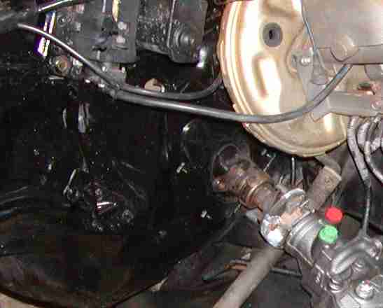

I found out something that I have suspected for a long time, that my car was an M40 before it became an M21.
Had to have the linkage replaced today, after 10 years of aggravation with never having it shift quite right. Turns out that the shifter plate was for a 3 speed trans. Now the shifter sits about an inch or so further back, so no more knuckle mashing shifting into 3rd. However, I was informed that there are 2 weld nuts at the top of the trans tunnel, and the opening for the speedo cable has always been for an auto.
Big Question: How many Berger cars were sold with the M40?
Copo.com does not list any.
Any Help?
Thanks, Andy
COPO 9561/9737 M40 X11D80
13.37 @ 105.50 on pump gas,drove it to NATL TRAILS and back [email protected] SCR22

The weld nuts are for a console but both auto and stick used consoles. Are you saying the speedo cable does not cross the firewall and go down the pass side of the tunnel ?

The shifter hole is larger than a non console car. This is why there was room to move the shifter back.
Since my wife copped a plea to involuntary manslaughter, I won't have my new camera til next week. I will try to get a better pic of the fire wall.
Back to the big question: Any Berger cars with an automatic?
