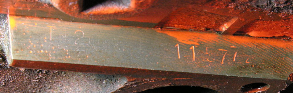

I have a numbers matching 66 SS. The block stamp is very faint. You can see the vin# quite well. The T+date is very faint and the "EJ" and "Z" (for Fremont) are VERY, VERY faint.
The EJ & Z are only visible in perfect light and at the correct angle. I have not been able to get these to appear in a photograph. I'm not sure if there's any depression left from the stamp. There's probably just a variation in the metal that makes it visible. I had a friend that is a professional photographer look at it and he said it can't be photographed unless something can contrast it and make it pop a bit. I've tried to use a very light coat of paint and rub away the excess and this did not help.
Does anyone have any suggestions? I really just want to get it visible, snap a few pictures and leave it alone. I also don't want to use the acid as I've heard that it's lost forever after the process.

Have you tried a pencil rubbing of the numbers ? Put a sheet of paper over the stamp and lightly rub acroos the stamped area with a pencil and see if the numbers appear on the paper.

Thanks Steve. Yes....I tried that early on. I also tried putting some chalk and crayon on the stamp and lightly wiping away the excess with no luck. As I said, it's like the depression is gone.

A guy I talked to last week said there is some kind of acid you can treat the area with that will make it pop a bit. Even works sometimes on blocks that have been decked because the metal where it was stamped is more dense (or was that me?). Anyway, I don't know if it would work for your situation because it sounds like the stamp was so lightly applied that there is hardly any depression.
I will see him this Sat nite. If you send me a PM to remind me, I will ask him about the procedure. He is a real "car guy" so he won't mind talking to you directly.

I've heard & read about the acid that law enforcement agencies use. Apparently, that stuff makes the stamp visible for a short period of time (like 10 minutes) to enable a photograph, then everything is obliterated permanently. Hopefully, it's not the same stuff.

I've tried it. It DIDN'T work for me.

Maybe if you have it Magnafluxed?

About the stamping......... Have you tried a digital movie camera. A DVC or DVD recorder for example. What's good about them is that you get a continuous image and you can tilt the camera to get the different angles. Since it is digital, connect to your computer and freeze the frame when the stamping appears. Then you have your photo. I would not use any type of acid to make the stamp more visible.

Have you tried rubbing it with a piece of Charcoal,then take a piece of pine wood similar in size and wrap that with ONE layer of tracing paper around it.
Set it on the Block pad,and smack it "HARD" with a metal hammer.
Lift the block off,and study the tracing paper,as well as the engine pad.

Put the block in the freezer,metal might shrink enough to give an impression thru a piece of carbon paper or carbonless paper---
