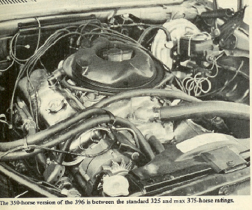

I thought all 4 speed BB cars in 69 had smog
Bill Pritchard
Old 03-27-2005, 12:16 AM
Location: Woodland, ca. US
Posts: 16,045
Thanks: 530
Thanked 4,969 Times in 1,263 Posts
Default Re: help! correct redline tach for 69 396/325 4speed
As far as I know all the 69 Camaro's with big blocks had smog. Maybe a Canadian car with smog delete might exist ?
