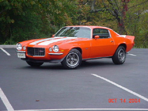

Default 1971 Huger Orange Camaro RS Z28 Immaculate EBay
I just posted a 71 RS Z28 on Ebay. This is a very clean car. It is not matching numbers but is a fresh resto. Check it out:
1971 Camaro RS Z28

Default Re: 1971 Huger Orange Camaro RS Z28 Immaculate EBay
SuperNovaSS, you have 427 feedbacks on ebay!
That's a beautiful Camaro - It is more 1970 than 1971! Looks like a few other nice cars in your driveway too!

Jason... Just a quick question... Should there be a Posi-Rear sticker on the bottom of the trunk lid next to the jacking instructions sticker? I have seen some Z28s with and without that sticker. Thanks.

It depends whether the car came with posi or not, it was optional. The car is sold by the way.

In the 1971 Z/28, 3:73 posi was part of the RPO Z28 Special Performance Package. Only a separate option in other Camaro models.

I dought very much that those 70 seats made it into a 71 from the factory. I'd say prove it .

You know I am glad someone else noticed that. Vega high back buckets are the correct seats. The whole interior is wrong right down to the 1970 steering wheel. The sill plates by the way are on the wrong side.
This statement bothers me as well.. "The car is painted Hugger Orange, a top performing color in 1971". Hugger Orange was NOT available in 1971!
The emblems are wrong for 1971. The spoiler Z28 emblem was a decal. Space saver was a 1973 option.
The whole car was built to simulate a 1970 Z/28. There is so many things wrong with the car, without supporting documents showing that this is a true 1971 Z/28 this is one car I would walk away from. There is some big money on this car right now and I hope the bidders understand what they are getting and have asked the right questions.
