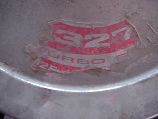

Need some help with a discussion on another forum. Can anybody here confirm that a 68 Corvette with RPO L79 would have had a cast iron intake and Qjet ?, or is there a website I could get positive info from ?.

Thanks guys , this is the engine at the center of the discussion...........
http://cgi.ebay.com/ebaymotors/ws/eB...category=34202
Just trying to determine if the intake and Qjet are correct .

--------Add says HE stamping......Therefore a 300/327 68 Vette motor.It,of course,would have had a cast-iron intake and Qudra-jet.Valve covers are correct as well,I think............Bill S
