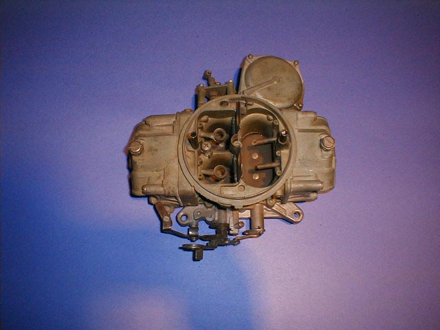

WELL I FOUND THE NUMBERS ON THIS THING NOW CAN SOMEONE TELL ME WHAT THEY MEAN? THE LIST IS 4604-S AND THE DATE IS 954. THE OTHER NUMBERS ON THE CARB ARE 6R 2728 OR THE 8 COULD BE A 6 NOT SURE. CAN SOMEONE TELL ME WHAT SIZE THIS IS AND WHAT CAR IT CAME ON? MAYBE ITS A 1050? YENKO? BALDWIN? ANY HELP WELCOME THANKS
a quick way that i usually use to identify a 950 from a 1050 3-barrel is that if the rear(large oval barrel) 2 sqirters are round like the front 2 squirter it is a 950 cfm unit (all squirters are the same shape)....a 1050 cfm will have two straight squirters for the rear (large oval barrel) and 2 round squirters in the front....the picture is of a 1050 cfm model
ok....we'll try this again..... [img]/ubbthreads/images/icons/mad.gif[/img]
a holley 1050 cfm 3-barrel
