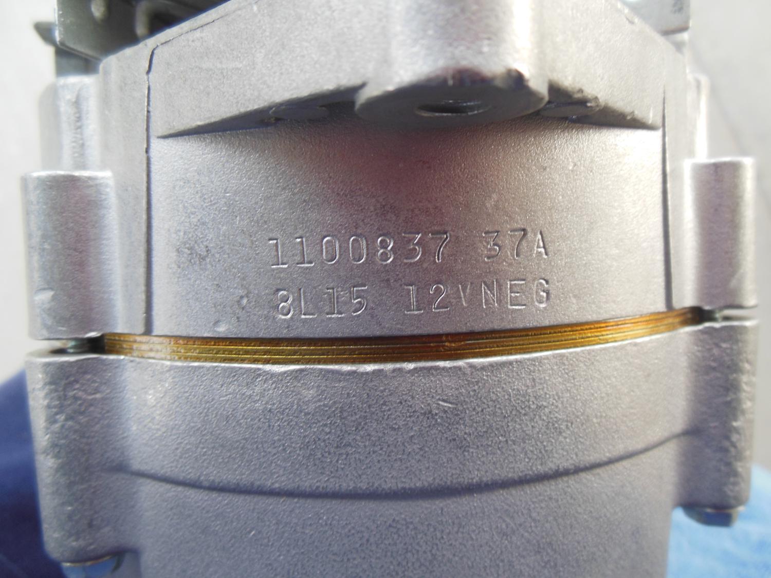

picked this up the other day ?
Attachments - The Supercar Registry olebluealtdate.jpg DSCN8663.jpg 1100837 9A14 good.JPG

Not typical roll stamp.

I totally agree with Steve. Plus, the only known dates I have for November of 1968 are 8L2, 8L9, 8L23, 8L27, and 8L30.

Nice "TRIBUTE" Alt #837.
It is a nice piece tho. Clean. I would Run it.

With the roll stamp usually the ending stamps are not as deep as the beginning stamps.

This is a picture of a good roll stamp and known date.
