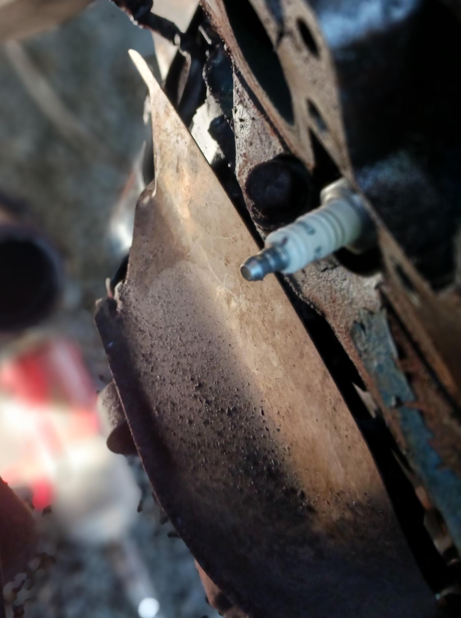

Need confirmation on the size of this Starter heatshield Hex Head,is 5/16-18 X 5/8 what was used originally?

Cannot find a good pic of it but it looks like a corner oil pan bolt??
The tube nut is not on rear solenoid screw, but we have it.
Did not take bolt out to check but it has a lip like pan corner bolts.

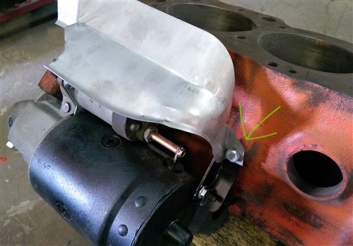

Here is a pretty good picture...

Another look at a 1970 [according to ad].
Sure looks to be 5/8" to me.
Has lip also.
