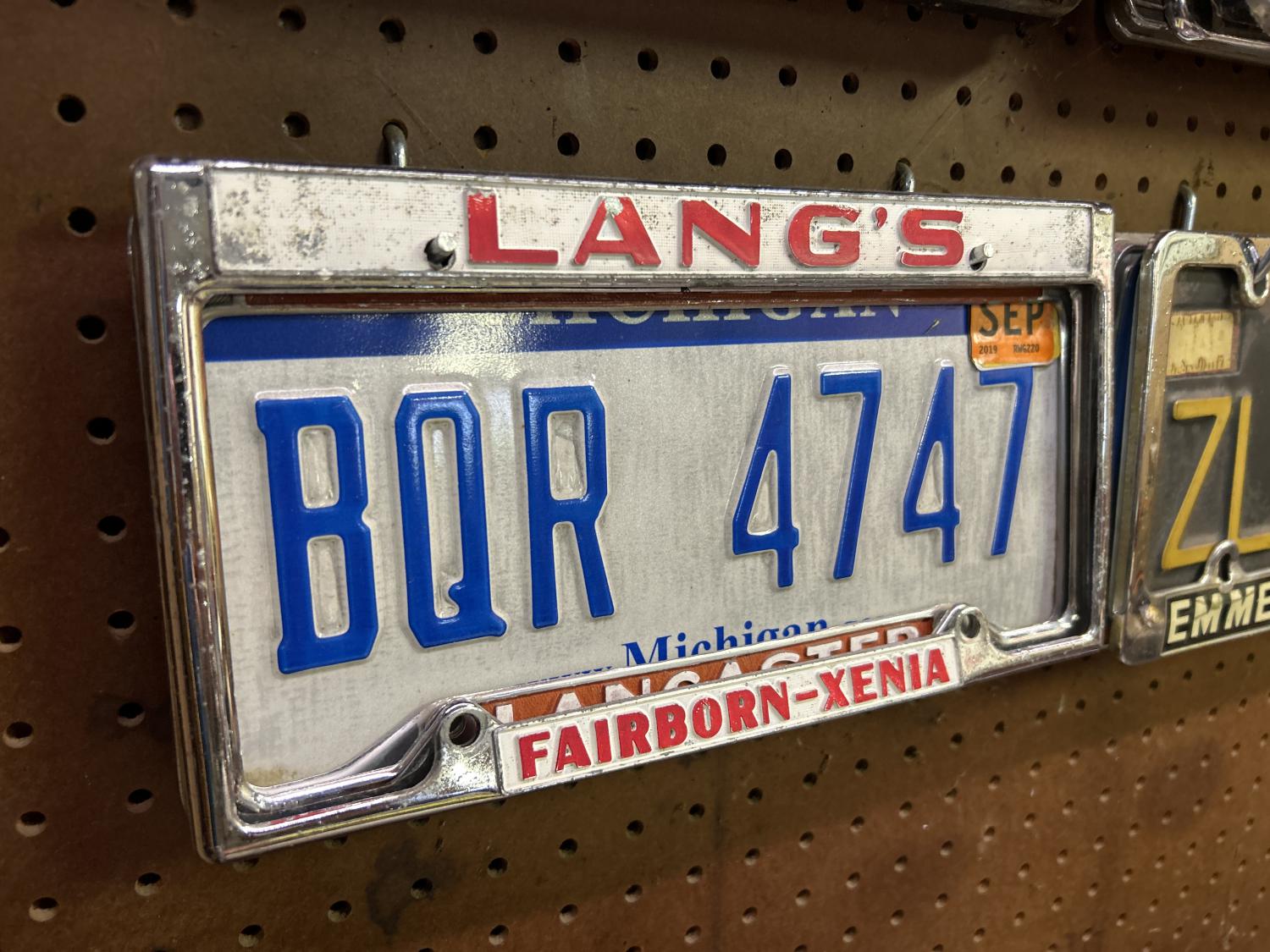

Great NCRS result as lots of performance cars were sold at Lang Chevrolet whose owner was Dick Lang, a well connected road racer we’ve discussed here in past threads. Cool your car has the 4:10, is it a stick, what’s the build date also please tell us more about it. Here’s a few pics also old Lang Ads w/ Camaros. ![]() ~ Pete .

Hello Pete. Hey, neat pics, thanks for posting them! I really enjoyed the history of it all! The car is currently automatic, haven’t looked around for evidence of any manual stuff yet. Did find the headlight switch had the vacuum hoses still in tact, headlight doors are just wired open. Looks like 4th week of January is the trim tag build date. Interior is deluxe with houndstooth seats, tach and gauges on the console. Still has dual piston calipers up front. I remember in the late 80’s we couldn’t get calipers, had to have a guy rebuild what we had. Corvette is the same caliper I’m told?
