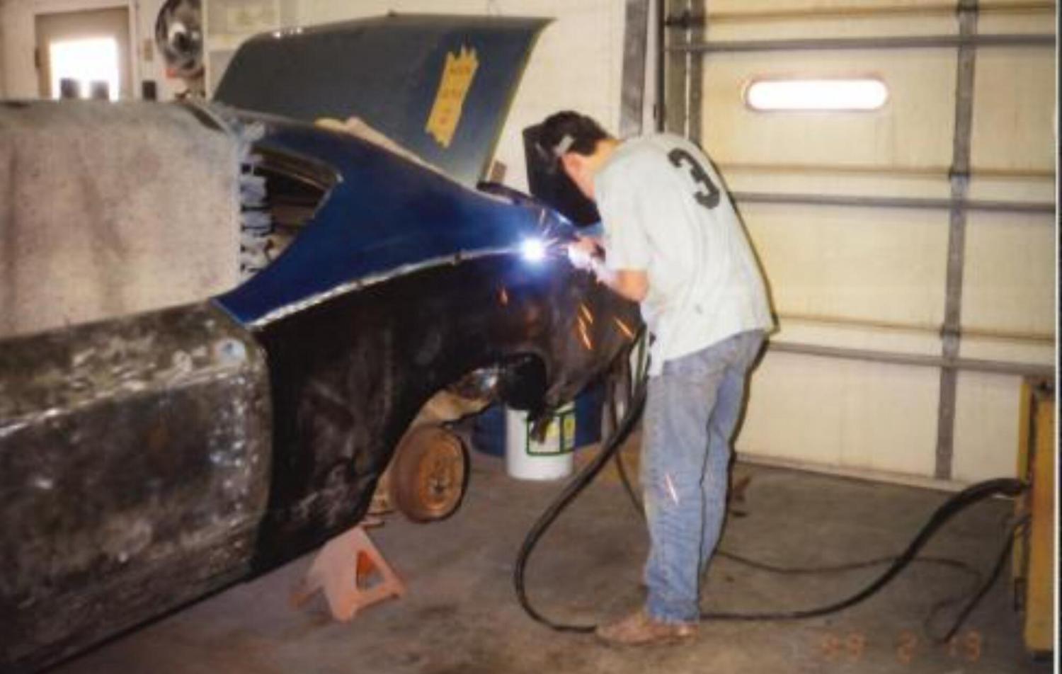

The next day, I found some blue enamel that matched, brush-painted over all the rust, and sprayed black over all the lower body argent silver which hid the rust well. I had bought some 15x7 ralleys, and got the used tires off my parents' Caprice. The car looked great from 50' away. Unfortunately, I never took any pictures of the car at that stage... It only lasted 30 days on the road like that.
That winter we started the body work at Dad's body shop. This was planned to be a quick job over one winter, but the project stalled out for a little while after the metal work stage was done.

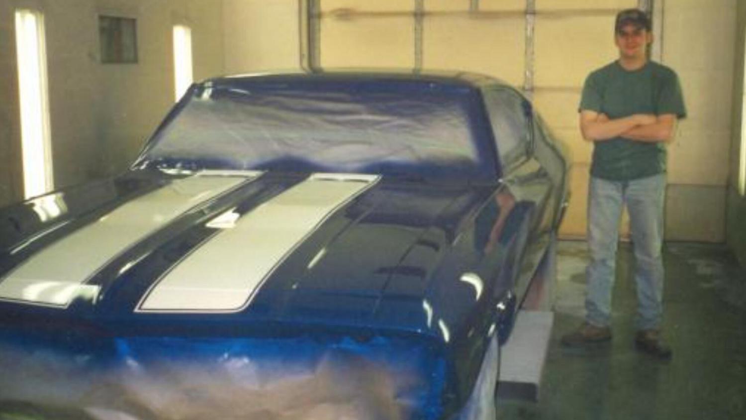

Spring of 2001 we got serious about getting paint on it and freeing up the space it had been occupying in Dad's body shop. Huge thanks to Dad, the paint turned out awesome, and still looks great 20+ years later.

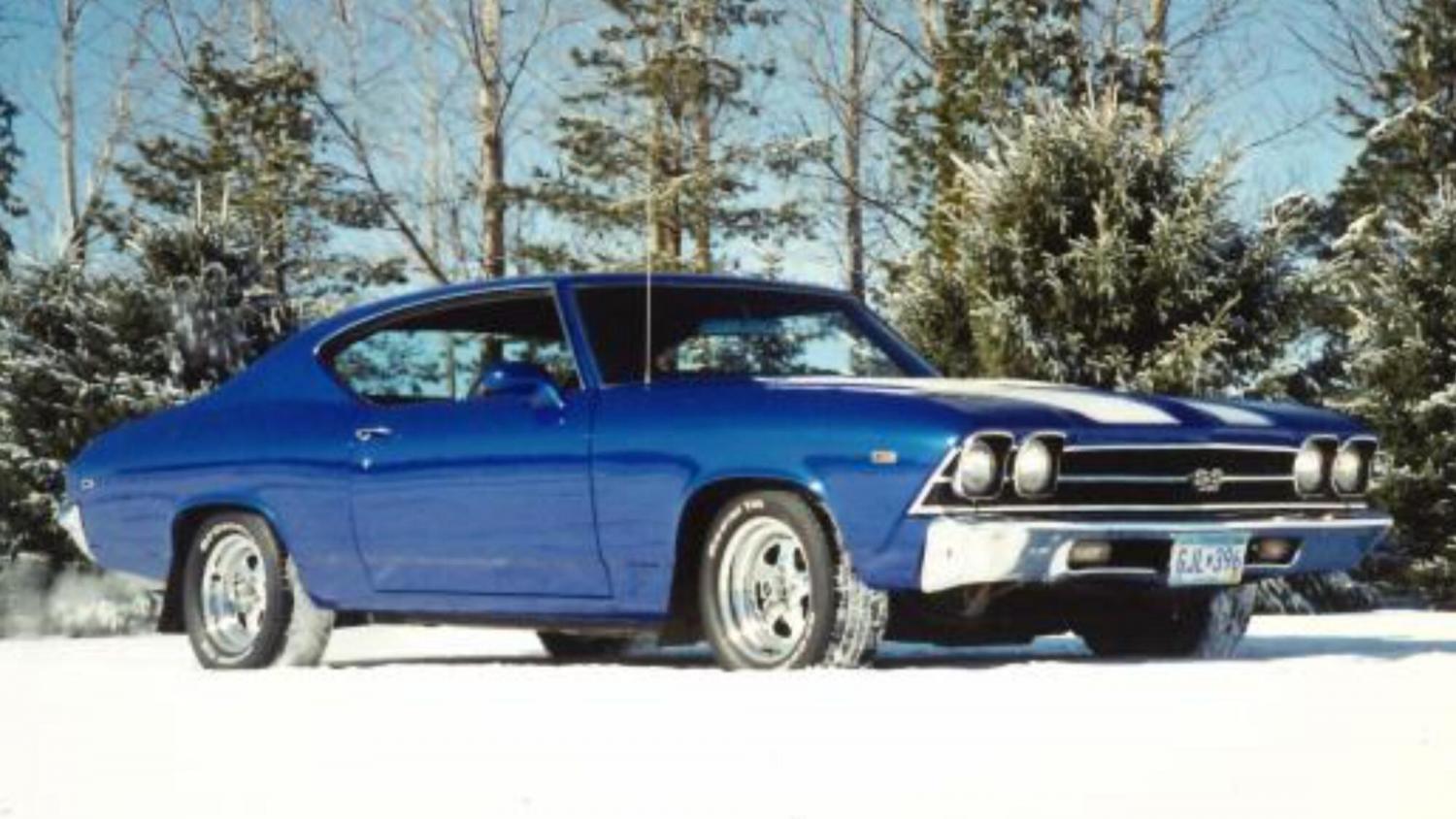

After paint, I assembled the Chevelle in May of 2001. The picture on the trailer was when we hauled it to a shop for exhaust and alignment. I was finally able to drive it to school the last 3 days of my Senior year.
With the completely stock drivetrain it was a very nice comfortable driving car. I drove it daily like that during the summer for two years, putting 9,000 miles on it in 2001, and 8,000 in 2002.

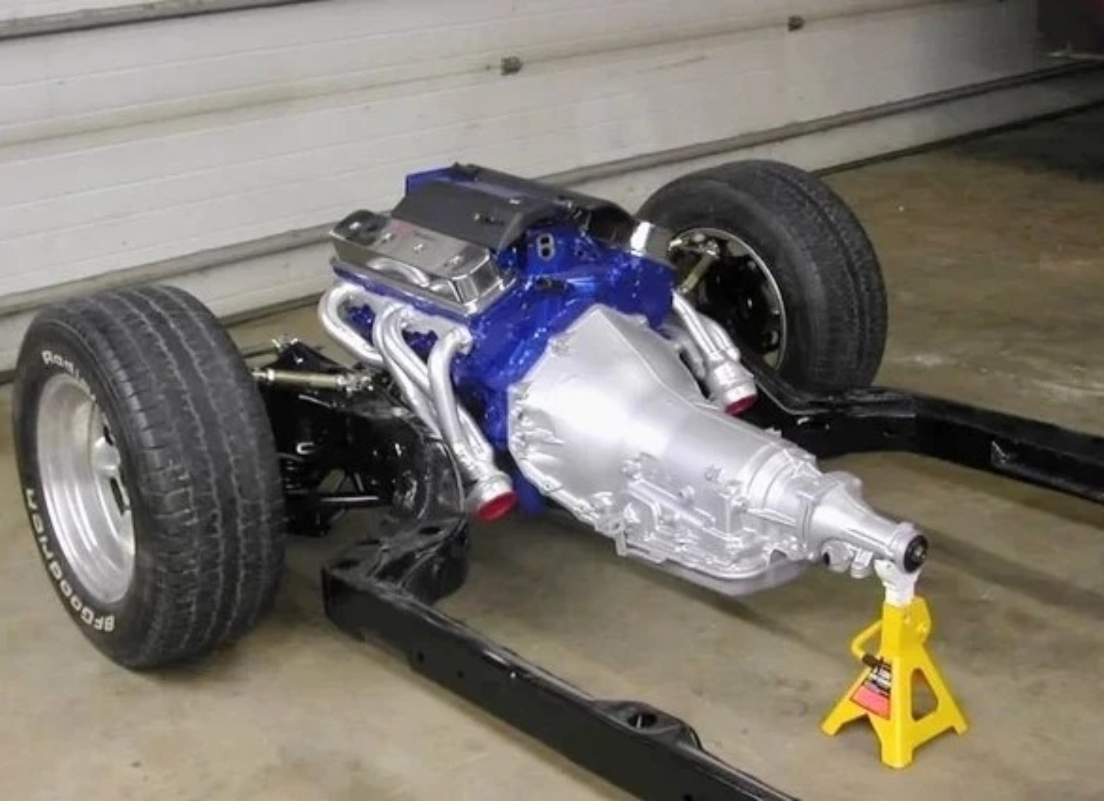

The original frame had a lot of rust, so I bought a better one, boxed it, and started building my first suspension setup with handling in mind, using mostly dirt-track parts and tall balljoints with stock spindles. I started building the new setup while still driving the car.
In the fall, I took the car apart and got to work on the frame swap. I was young, energetic, and didn't have kids yet, so things actually moved forward at a pretty good pace. I had a deadline though, Jenna and I were getting married in May and I wanted to drive it to and from the church on our wedding day.

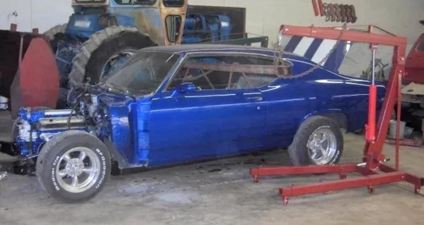

We bought a 66 Chevelle wagon for Jenna that needed suspension and brakes, and there were some cool new things coming onto the market, so in 2007 I swapped most of the setup from my Chevelle onto hers, and I bought the new ATS AFX tall spindle, SPC A-arms, upgraded to C5 Corvette front brakes, and 98-02 Camaro rear brakes on a used 12-bolt with 4.10 posi. The new brakes required new wheels, and I scored a deal on some 17x7 and 17x8 from Billet Specialties.
With the change to 4.10 gears and stickier tires, I improved my 1/4-mile ET to 13.62 at 98mph. I was losing interest in drag racing though, and focusing way more on making it handle.

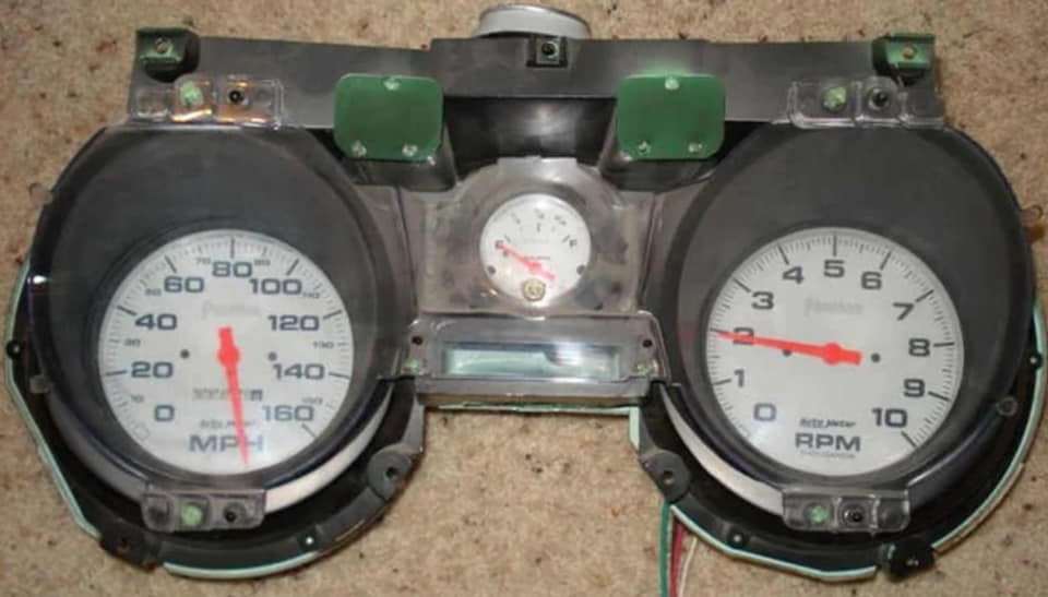

In 2008, after 2 years of driving with no speedometer due to the modern transmission not having any way to run a mechanical cable, I decided to adapt an electronic speedo into the stock dash. I also wanted better seat bolsters to hold me in place while cornering, and to change the interior to "parchment" off-white from the original black.
Scat had just introduced their new "Procar Rally" seats, which had nice bolsters, but also styling and sized to look great in a musclecar without the high-backs that most other bolstered seats had. I decided to buy those seats, and have them custom upholstered with correct '69 style pattern inserts. It was kind of expensive, but worth every penny! I still love these seats.
For gauges, I wanted white faces to tie with the interior color and the stripes, so I cut and welded on the gauge panel to adapt 5" Autometer Phantom speedometer and tach into the stock cluster, and put a gas gauge in the clock location. One cool original feature on a 69 Chevelle dash that I knew I would miss was the little blue bowtie for the bright light indicator. I designed a small custom bracket and panel with a blue bowtie light to go in the PRNDL location. I also used the Corvette style font but read CHEVELLE instead to tie in with the Corvette brakes and fuel rail covers.
I finished the install just in time (bolted the front seats in while Jenna loaded the trunk) to drive the car to Nashville, TN for the Chevelle-abration show in June, and while the AC didn't work yet, the white interior proved to be a good choice in the 105° heat down there!
