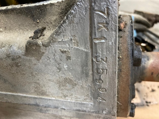

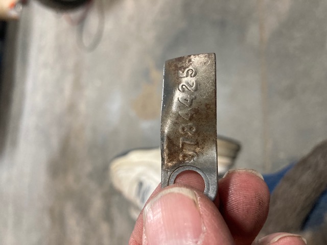

Picked up a Muncie 4 speed over the weekend and the guy said it was from a 67 Lemans with a 326 2 barrel. It still had the tag on the side cover and from research it comes back as 67 GTO wide ratio. Was the 326 available with the Muncie 4 speed? I know in the Chevelles that the base V8 got a saginaw 4 speed but not sure on Pontiac.

Yes, also available in the LeMans, same M20 wide ratio transmission as GTO.
