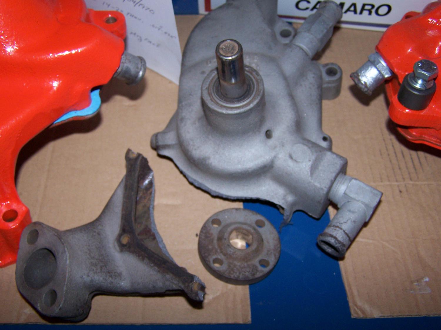

Calling DIYers: Anyone use one of the rebuild kits (link below)? My aluminum short pump part number is 3975928 (GM OTC for BBC applications). Multiple vendors provide kits but, can not confirm whether the kit can also work with an aluminum pump, only that they are for 396/427 application. Most of the pumps for this application are, of course, cast iron.
Thanks, Sam

I do pumps DIY style and have never tried doing a Alum, I wonder what the added risks are given the delicate alum structure. As in Support could be WAY more critical of a softer metal structure?

I had my aluminum pump rebuilt a few years ago. The company that did it wouldn't disassemble it, so I had to do that myself. They said they couldn't guarantee that they could get it apart without breaking the casting. I took it apart and sent it to them and they did a good job putting it back together.

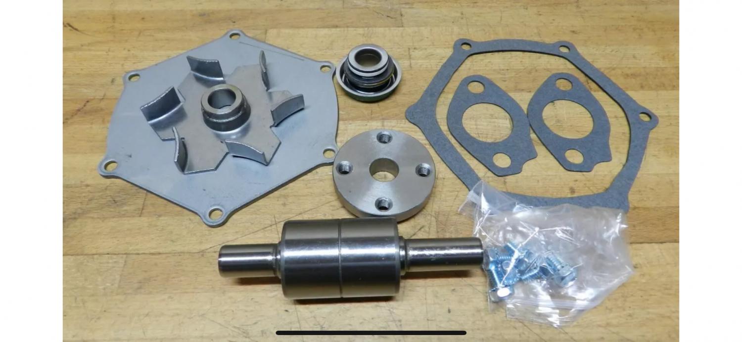

I bought a few of these kits from these guys in Oregon off Ebay. They worked perfectly for my cast iron 69 Camaro water pumps. Supporting cast iron pumps in the press is very important, I would think Alum ones are even more important!
1969 Chevrolet Camaro Z28 302 5.0L V8 New water pump rebuild Kit 3927170 3953692 from 2ndgenautoparts

It was dated 66' and was serviced at some point. I ended getting a 1967 dated correctly from a vendor. They (GM) went to a larger Bearing in 1970' I think and making sure you get the correct kit is important. Then Properly Setting the internal seal is tricky that required special tooling

Update. I have a GM aluminum water pump due here this week. I received the rebuild kit from 2ndGenAutoParts. I also got their 3D printed special tool to install the bearing to the shaft.
https://2ndgenautoparts.com
Ignore the hub in attached photo - they substituted the correct 8-hole hub in my kit.
