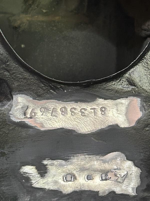

Buyer Beware. I purchased YS-8035 at Mecum Glendale 2023. I found out after the auction it was a rebody. Mecum took the car back and required the seller to repurchase. Barrett's ad states, "the original restoration required utilizing body and cowl sections from another Camaro, eliminating some original confidential VIN numbers." Needless to say, it is a little more than that. There is little out there on this car as it has purportedly been owned by the same family for 40+ years. The car has some of the best Yenko documentation I've seen, but don't be misled by the paperwork. I hate to discredit anyone's car, but a rebody is a rebody. If anyone has questions, please ask!

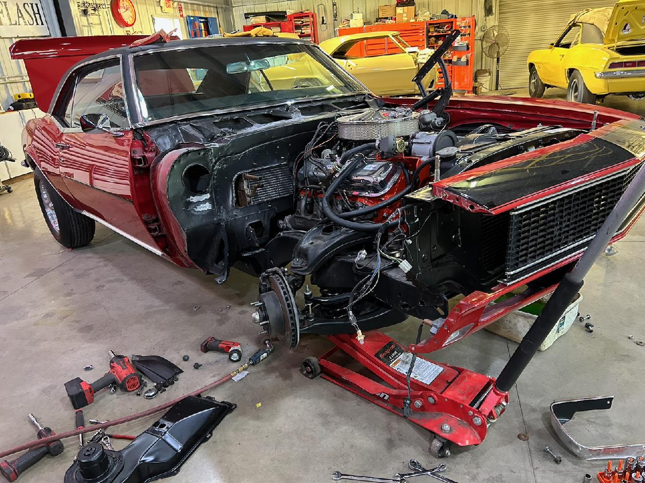

Just a few of the pictures we took...

From the Barrett-Jackson description "The original restoration required utilizing body and cowl sections from another Camaro, eliminating some original confidential VIN numbers and ultimately requiring a state-assigned VIN."
It looks like they used a complete Los Angeles built body from reading the hidden vin.
The description says "eliminating some original confidential VIN numbers". It looks to me like all the confidential vin numbers are gone.

It is a full rebody. History was tracked back to the original owner. Pictures were taken at Frank's shop.
