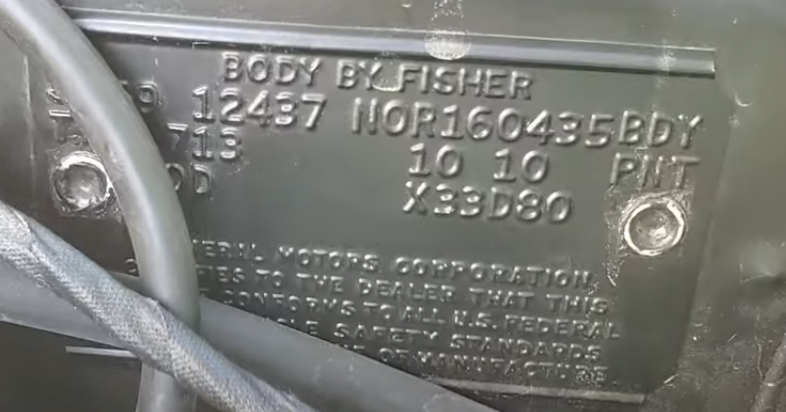

Beautiful car about the holy grail of 69 Z-28's, too bad it looks like the trim tag is fake....

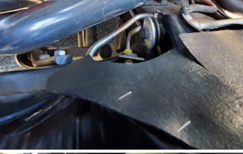

Old 08-21-2024, 06:23 PM
Posts: 21,013
Thanked 3,720 Times in 1,496 Posts
His upside down/inside out cowl seal too........again.
VIN 124379N703782

Old 08-21-2024, 07:26 PM
William William is offline
Join Date: Jun 2001
Location: New Berlin WI USA
Posts: 2,692
Thanks: 264
Thanked 3,010 Times in 835 Posts
They did.
Has a shopping list of issues, the splash seals crack me up!
Ad states Sale Pending.

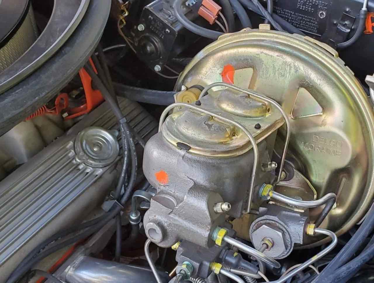

Old 08-21-2024, 07:36 PM
1967Z28's Avatar
1967Z28 1967Z28 is offline
Posts: 2,190
Thanks: 2,092
Thanked 1,480 Times in 531 Posts
Chinese booster too.

Thanked 8,922 Times in 1,803 Posts
This car is local to me. A friend asked me to inspect the car 3 +years ago and several owners. I spent 5 minutes and said I've seen enough Nick don't even consider this car. Just a put together train wreck....

Old 08-21-2024, 08:05 PM
Lynn Lynn is offline
Location: Oklahoma
Posts: 7,934
Thanks: 111
Thanked 3,721 Times in 1,568 Posts
Not even a good fake.
Old 08-21-2024, 11:05 PM
olson396 olson396 is offline
Join Date: Aug 2005
Location: IL
Posts: 88
Thanked 13 Times in 4 Posts
All those yellow inspection marks!!! I just hate when people just make stuff up.
Old 08-22-2024, 02:46 PM
Location: Marine City, Mi.
Posts: 9,519
Thanks: 33,858
Thanked 4,686 Times in 1,982 Posts
----An overdone paint dab masterpiece!....Bill S
Old 08-23-2024, 02:52 AM
MosportGreen66's Avatar
Location: NY, NY
Posts: 8,736
Thanks: 1,093
Thanked 1,060 Times in 472 Posts
Reproduction cowl tag
