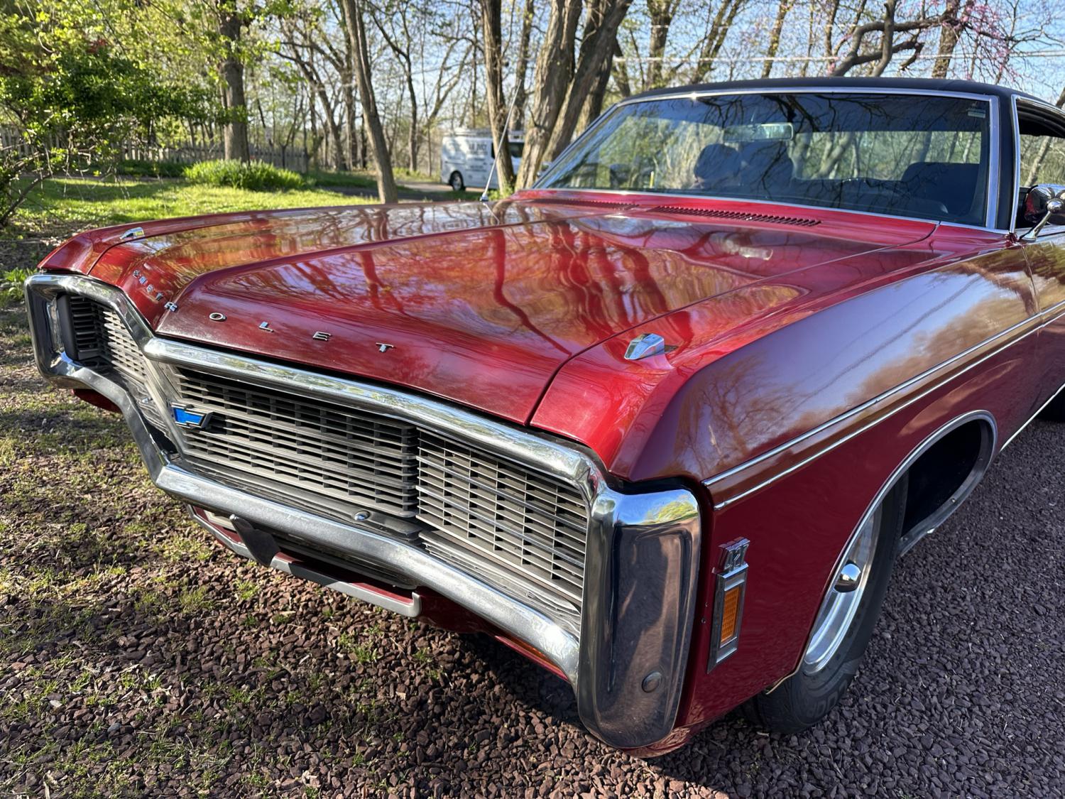

The guy that is going to paint my cuda convert has a 69 impala he got out of a barn that is a convertible, has a 427 390HP engine, yet is not a SS427 car. Someone told him it is likely rare, but he asked me if I could help find out more. Any help appreciated I can pass on to him.
Its yellow, mint black original top, and black interior (bench with column auto).

not particulary rare but cool, desirable and worthy of restoring. 69 Impalas are not highly sought after and parts may be difficult to find especially trim pieces. But with a 427 and convertible top and yellow it will certainly float the boat of Chevy fans.

If I remember correctly a 1969 427/390 could only be had in a Corvette or an SS427 Impala. If it was in a standard Impala, Biscayne, or Caprice it was a lower horsepower rating like 360 or something like that. Bill

My recollection is that the full size 69 Chevys had three different 427s available: 335, 390, and 425 HP.

I could be wrong, but I don't think any of the available 427's were limited to the SS427 model. Wasn't there a wrecked 427/425 4-door sedan in barn finds at MCACN a few years ago?

Yes, The Leunig's had their 425HP wrecked sedan there. Regarding the SS cars, only the 390 or 425 horse engines were available in an SS, and a factory 390HP non-SS car is pretty rare. That engine would have painted valve covers and air cleaner lid, as opposed to the SS which would be chromed.
