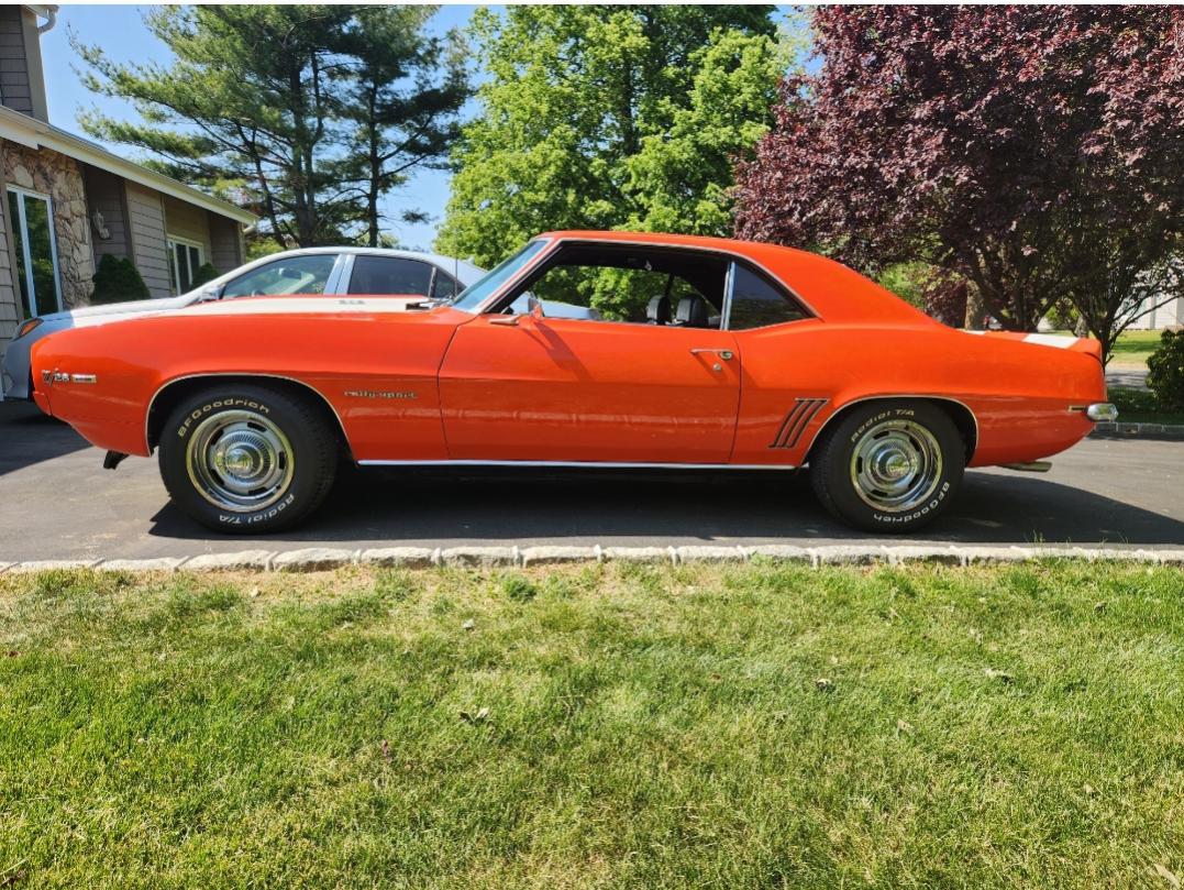

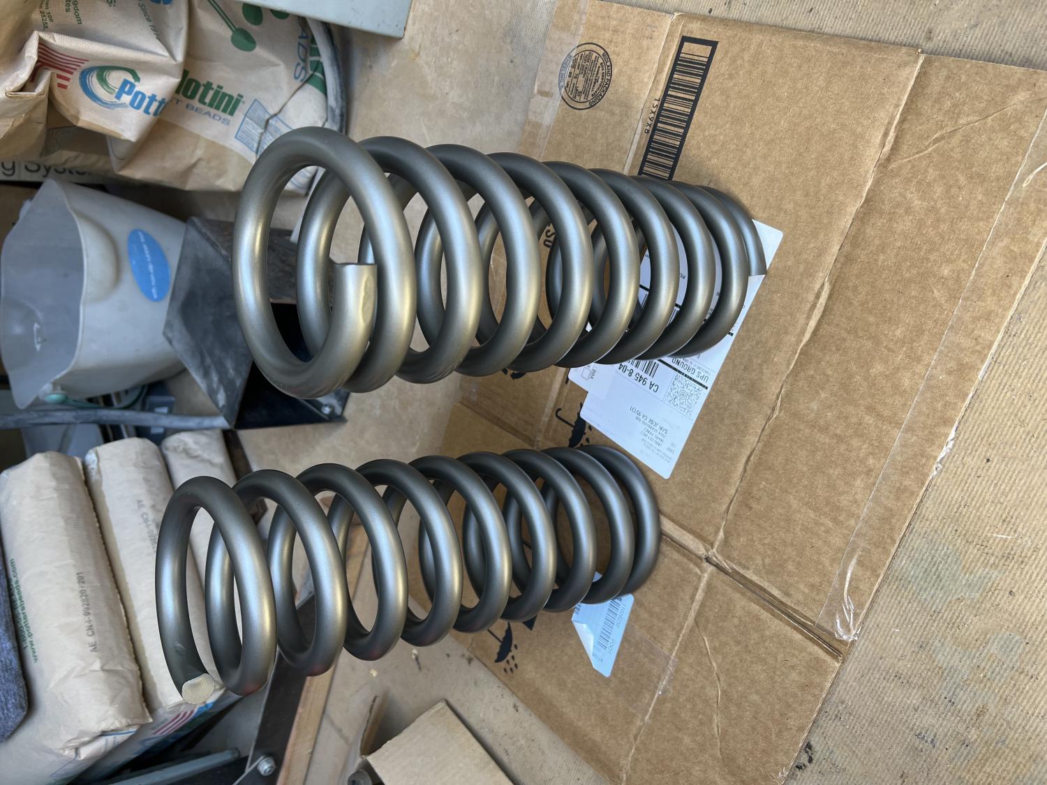

Steve, I worked with Kevin at Coil Spring Specialties last year on a custom set of front coil springs. I first ordered in the spec recommended by Wayne D Guinn which brought my front fenders down to about 25 3/8”, measured from the center of the fender trim. I wanted lower to sit level with the rears so I ordered a second adjusted set that got me to 24 3/8”. I bet you can ask Kevin for the spec that Matt from California ordered last year. Or if you want 25 3/8” I’ve still got those in a box. Here are a few photos of ride height on 215/65 BFGs. DM me if you need any more details.
Thank you to Motorhead848 for refinishing and installing them
The car stance is perfect! I used them in the mid 90's on a 69 Pacecar big block auto with A/C. I tried 3 sets from Eaton springs with horrible results. I then contacted Coil Spring Specialties and first set were perfect.
I was contacted from a member and just purchased a set of unused 6308.. BTW our cars are twins!!
I have 215/65/15 front and 235/60/15 rear. They have almost identical diameters...

Mark, so far I’d say it’s within 1/8” of the day you installed them, though I’ve (sadly) put maybe less than 100 miles on the car since the install. I’m expecting a bit more settling than that so we’ll see after I replace the dead fuel pump.
Eddie, here’s the page in the AIM about ride height. I’ll have to measure from those locations and compare, but certainly the look I prefer is level and with the tires slightly tucked into the fenders. I like to think GM Styling would agree
I should also say that my springs from Coil Spring Specialties are 507 lbs/in, which is stiffer than stock. The front feels very planted in cornering without a compromise in ride quality
