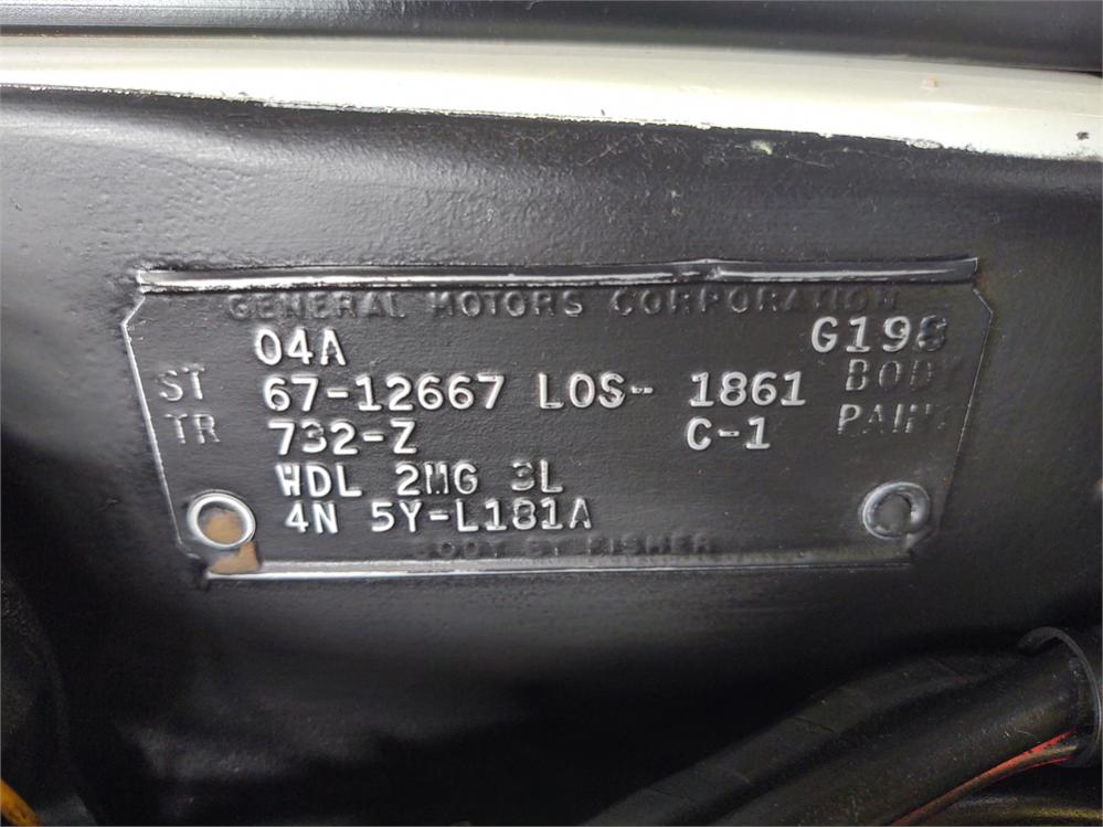

Co-worker works on the auction side so he was asking me my thoughts. At the time, he didn't have any pics of the data plate, with the seller only claiming it said 4N for the L35. Now it's been uploaded, though I am guessing it would need docs to prove its pace car status?

looks like it has the special order code on the trim tag

Looks correct to me for a Van Nuys built pace car from my knowledge of having owned one from 2005-2015.
