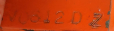

https://www.hemmings.com/listing/196...-camaro-601220
124379N668823
From the ad:
"The original 302 which is not currently in the car coded 3970010(v0612DZ) is included with the car."
Here's the pad.

That stamp, black grille w/black surround and still feels justified to ask $110k. Obviously well versed in correctness with that “no power steering” declaration.

Isn't that block a later model truck block with the narrow pad? Not even close to being the right block.
You are correct, the 1977 and later blocks all had the small pad, I call them the lightweight blocks as lots of metal was romoved to save cost.
